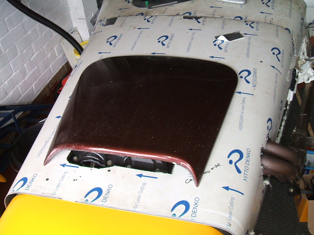

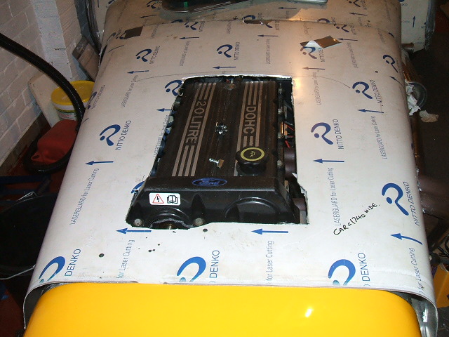

do you think this small vent will be enough to keep temp down :)
Are you going to mount your rear view mirror on the rocker cover?
I can only assume you were being sarcastic when you said "small vent" What are you going to cover it with and how comes its sitting that high? is this a problem with all the DOHC engines?
I have a kia sedona bonnet vent that just fits over the hole
I lifted the engine so that when the sump is chopped it well give me decent ground clearance
Cheers Paul

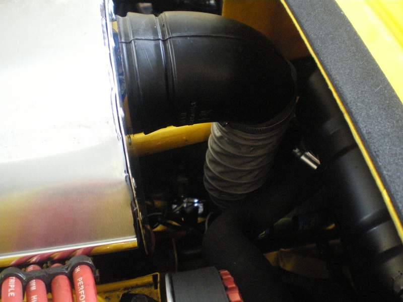

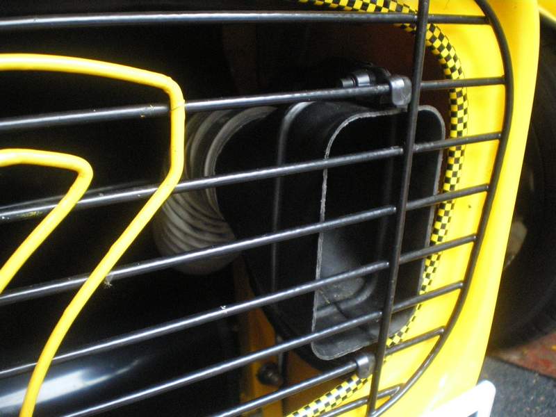

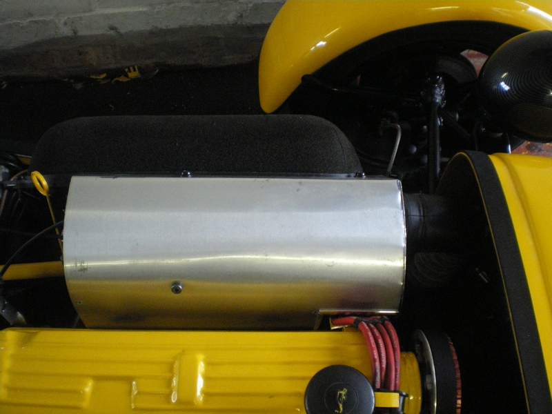

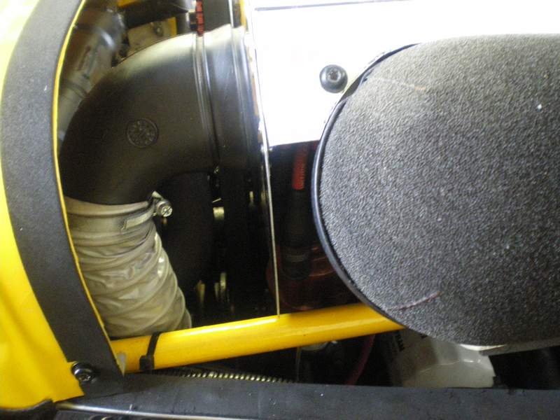

post-3394-096906200 1282466279_thumb.jpgpost-3394-004779200 1282466295_thumb.jpgpost-3394-008610800 1282466306_thumb.jpgpost-3394-094039400 1282466317_thumb.jpg
hi all,heres my attempt at trying to force air around the carbs.made from air ducts from a truck dashboard from work so no cost involved :D .
oh i forgot the realy expensive rivets from b&q,the robbing b;\'[;ds.£2.48 for 25 , 1/8 ally rivets,almost 10p each :o ,from my usual supplier they are 2 for 1p.any way moan over and job done,comments good or bad welcome.
