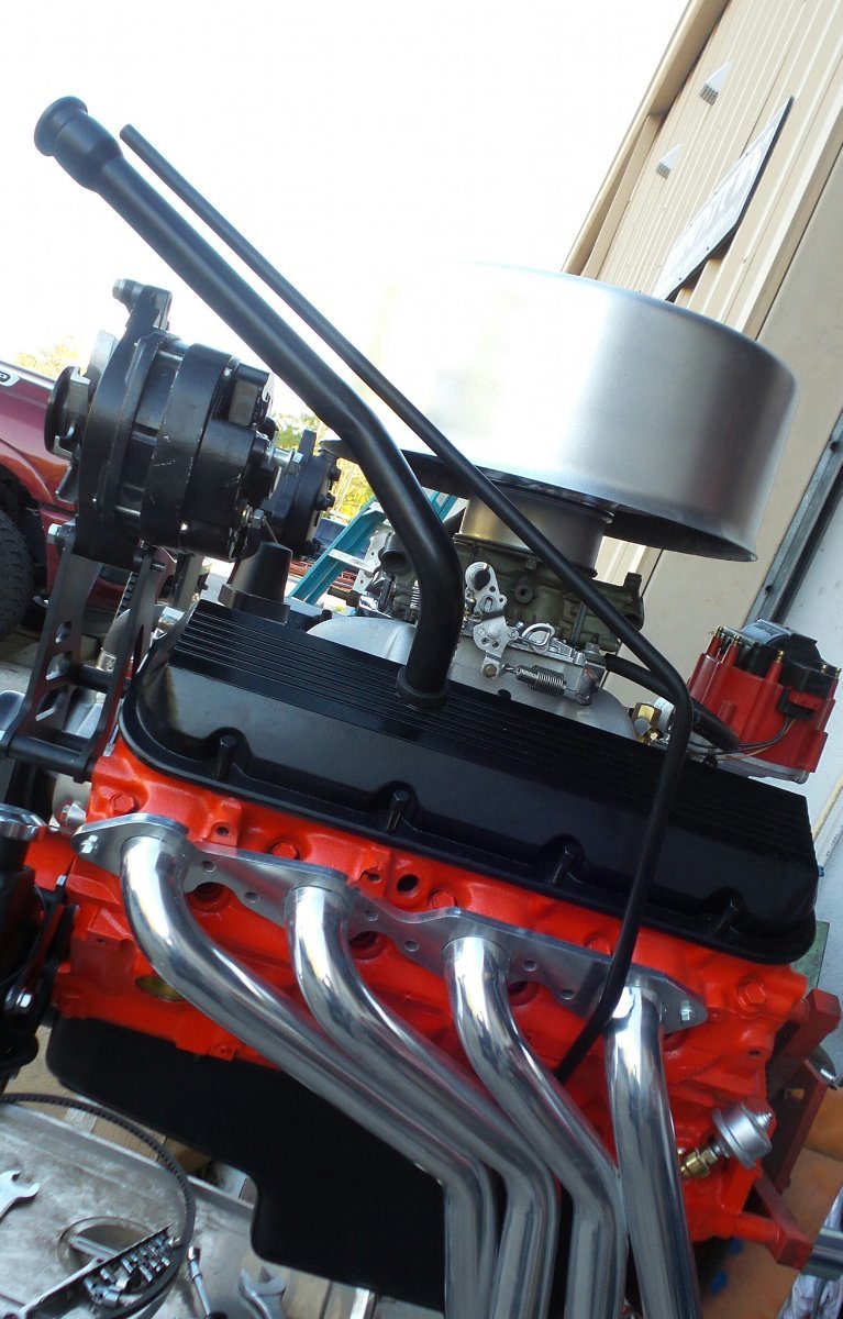

8mm or10mm microbore copper tube & spiral curtain wire allows for tube & dipstick to be set around obstructions. :rolleyes:

How is the dipstick going to get through the cylinder head & into the sump?
21 hours ago, IanS said:
I think that the small bore pipe is for the dipstick.
The Large bore is oil fill.
LOL that makes more sense
