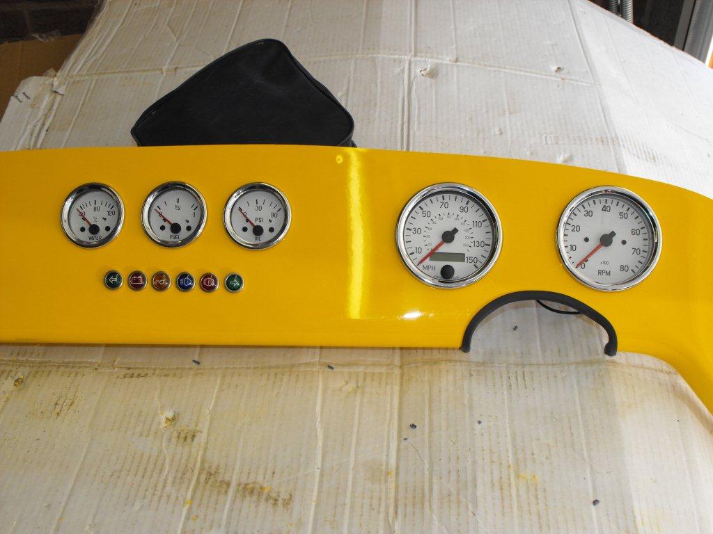

heres mine. plywood faced with fibreglass and covered in carbon vinyl. with etb dials,they are the cheapest around.
wiring wasnt complicated at all..plenty of guys on here would no doubt help out though
