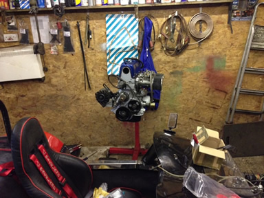

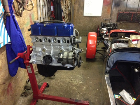

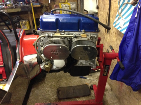

In the process of rebuilding my engine, nearly ready to fit just trying to decide which camshaft to use, I have been looking at the kentcam FR32 fast road. Does anyone have any experience with that cam or a better alternative?
I had( still have) an FR32 in an injection head on a 2.1 with bike carbs, 130bhp
It's a good easy on the road cam that will rev to 7500
The injection head is worth 5 to 10 bhp
The cam rated at +16bhp
The Pinto likes compression so at least fit a Rheinz gasket (1.27mm) or the Felpro this will give about 9.7 to 1, ideal would be 10.5 to 1
People tend not to understand that more camshaft duration means the inlet valve closes later so the piston is further up the bore before the mixture is compressed, this has the effect of lowering compression ratio, so you increase static comp ratio to compensate
Guest njavis
Thanks Snapperpaul for the info, my engine spec so far:
Standard 205 block from a low mileage Vehicle
Standard head which I have just had skimmed (to give a little more compression)
Felpro Head Gasket
Valves regrind/seated
New valve seals
New Newman camshaft followers
New Double Valve Springs
Twin 40 Dellorto carbs
Standard Sump
It will have a new Kent Cam FR32 (when I can afford it)
