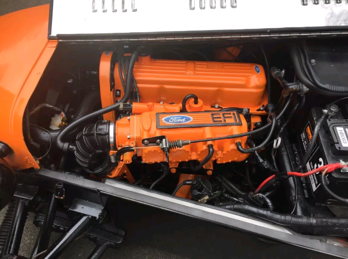

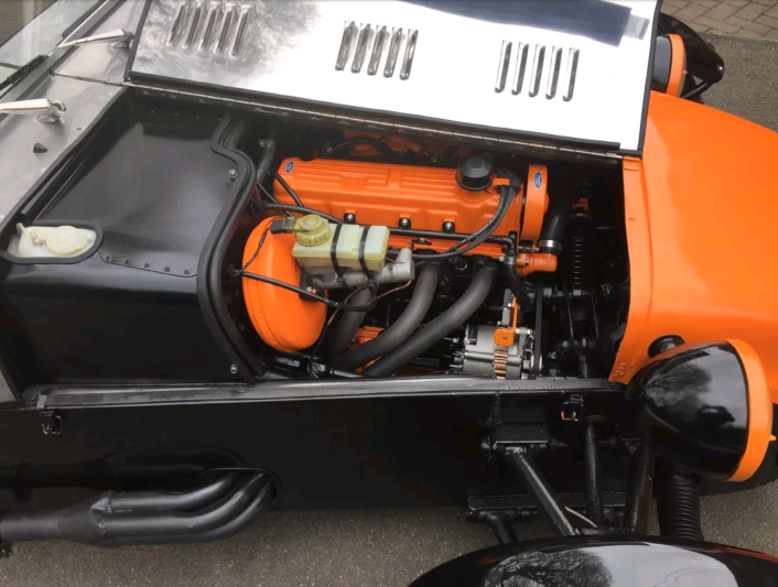

Pics
Rules out lean carbs then..!!
So, is you rad cap lower than top of head?
Can you take a pic of it? It may be lower in which case it will never fill correctly.
If it is lower try jacking up front end or driving onto ramps, fill to top and leave engine running with cap off. As stat opens it should begin to bubble and air will leave system. Top up untill this stops. Put cap on and test drive.
Fan is controlled by a switch on the dash rather than a stat, no idea why? It was defibately on and running before during and after the overheating!
There is now a small oil leak under the dizzy. The coolant obviously evapirated!, left spray marks on the engine!
Engine will still start, but have not done so since just after the breakdown. The engine is a reconditioned 2.1 pinto, rebored to 2.2 i believe. Oversized inlet and outlet valves. It was apparently using running in oil so i know that is due a change. Does that help?
