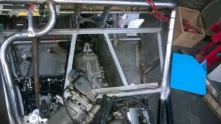

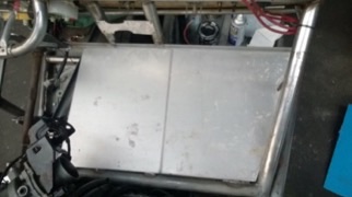

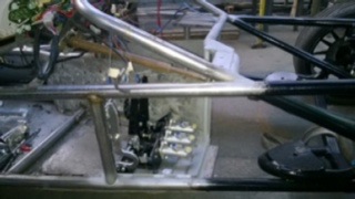

Floor mounted pedal box braced and fitted and frame work to hold the electrics and battery fitted with some 3mm aluminium sheet to rivet on top. This will give me access to the gear box if ever needed.
No servo on theses brackets so I will have to wait and see how they perform.

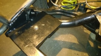

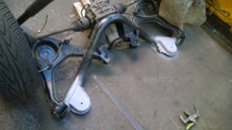

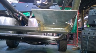

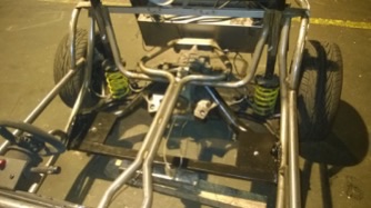

Rubbers removed , 5mm plate fully welded on top and 10mm hole drilled for a fixing point.
Old sub frame fixing point removed and replaced with 5mm plate. RH plates were 2.5mm/3mm very bendy,
New plates have gussets to take out any flex and a 60x30mm box running across the chassis will also stiffen everything up
Everything is measuring up square so I'm going to replace the 10mm bolts with m14. I don't think the rear end is going anywhere now.
