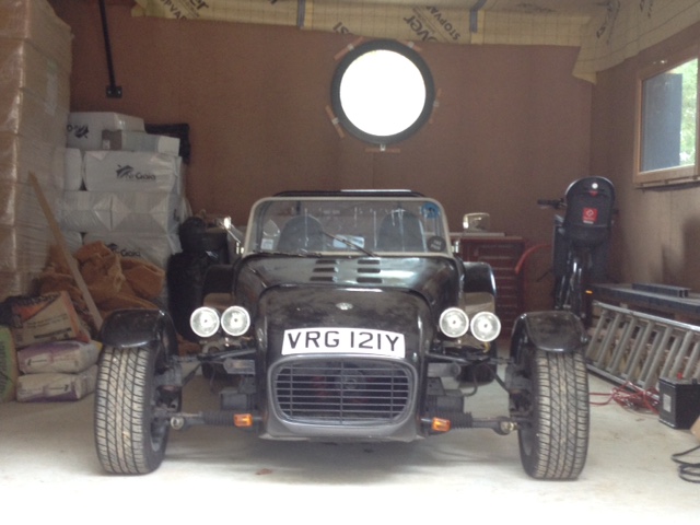

I am the happy owner of a robin hood, I look for information on this car.
She was registered in your club because there is a label on the windscreen in 2012.
- Would be him possible to find the manufacturer of this robin hood?
- what is the year of manufacturing of this frame?
- I shall want to know what typifies of engine of windscreen wiper is installed.
- Have you photos of pedals cubicle? Because mine is too close to the seat …
- Where may I find a textbook of manufacturing of the car? (PDF?)
- I look for lighthouses in 5 "
- I look for a condom(hood,great-coat) of roof
- How do you install(do settle) a spare wheel? Make you reinforcements of the back panel(sign)?
- It seems that the meter is the one of a Ford rave-up MK1, can you confirm it to me?
- What is what the reduction wheels, box, bridge(deck), meter gives the good speed?
- Can we install(settle) an electronic ignition on the engine 1600 l ford?

Guest 2b cruising
Can you tell us the registration number of this car.
I will not be able to help you out as I am only a recent member myself.
This information might be of use to someone from the club that knows the car and it's previous owners.
I think it is worth trying but the more information you can give, the better your chance of success.
Welcome to the club and I hope you are successful in your hunt.
Regards, Ken
Hi try this for identification http://nw.rhocar.org/identification.htm and let us know what you have.
is your engine the 1.6 ohc (pinto) or the ohv (kent crossflow)
the pinto looks a bit like this http://1.bp.blogspot.com/-SqnWgshSDUE/UJUu5oHGlHI/AAAAAAAAAds/mR3m7JopX0I/s1600/engine.jpg
the crossflow like http://www.heperformance.com/customer_rides/9BS2K5X/031ce077a25cb9eec30304c34b835894.JPG
note - exhausts exit on different sides
Both should be convertable to electronic ignition. once you know what you have.
where abouts in france are you?

Thank you for your great fast answers.
Hello, N is VRG 121Y.
I have the name of a person on V5 but I do not know if I has to give him to the forum...
It would be a S7 mk1 sierra but I do not know the year of production.
It seems to me that the engine is a pinto one.
The car is in conduct to the right and the jar escape is to the right also.
I am in has Limoges.Good evening.

Hi some answers...

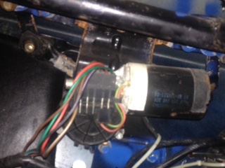

the most usual wiper motor is from a mini, the old one, not the new BMW one.
The spare wheel mounts on the back of the car resting on the rear hoop, and
bolts to the back panel with a long stud through one of the wheel stud holes.
The panel must be reinforced usually with plywood.
Kitspares are selling an S7 manual....
http://www.kitspares.co.uk/index.php?route=product/product&product_id=777
This company has a good selection of headlights (phares)
http://www.carbuildersolutions.com/uk/headlamps
Hope that helps,
Bob

My engine windscreen wipers is not a mini.
here is the picture:
the problem is that the diameter of my arm is larger than that of the mechanism so they swim in it ...
