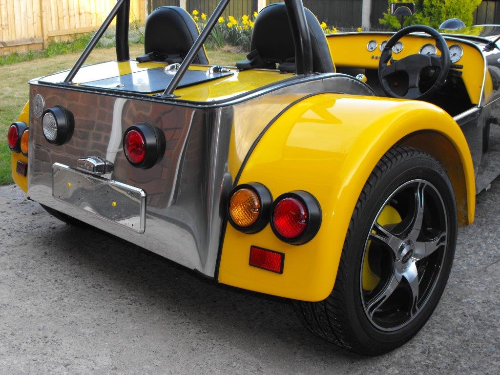

Just thought (probably should have before), it looks higher on the photo as it was on a pair of workmates at the time - sorry!!
I used a mount from Car builder solutions and pased IVA with no problems, just check fog light is properly marked.
is it my eyes or do they have a slight angle on the mount?
Yes the mounts ar angled so the lights are 90' to the road and take into account of the rear panel not being exactly vertical.
