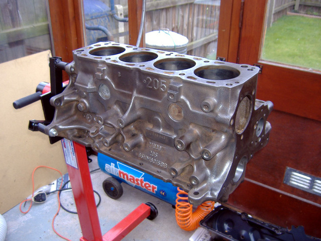

Thanks for you reply, it's got 165 on block, is this a better engine than the older 1.6.ones. Cheers. Dave
The early blocks were just 16, 20.
The later stronger blocks were cast 165 , 205.
Link to comment
Share on other sites
Can I highjack this thread and ask what my 1.6 is? I have always assumed it is the emax as it is from a 1985 Sierra. The engine number has LS in it so I assume it is the longer stroke engine. However the block has 164 cast into it. This has always confused me. Any clues?
