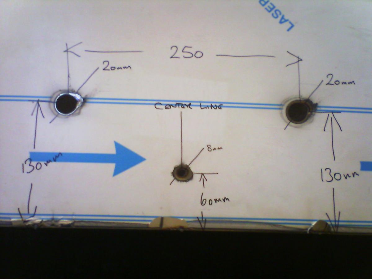

Hi guys I'm in the process of rebuilding my scuttle and was wondering what should the distance between the wiper spindles that stick through the panel. Also how far away should they be away from the window.
They are the lucas mini wiper motor set and spindles with mini wiper arms.
If it's any help, my 3A measurements are: 26.5cm between spindles, 5cm from base of screen. I use 20cm blades and adjustable length arms which I had to bend the ends to allow the blades to lie parallel to the base of the screen
