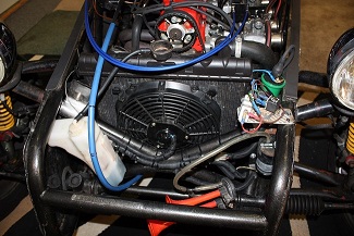

I have just recently purchased a 2B, Fitted with 2.0ltr Pinto , I think it has a standard radiator fitted with electric cooling fan support.
I would like to change the radiator from what I think is a standard unit , to something more robust and that will help the engine stay cool, I do not intend to race or track day the car.

The rad fan looks like one of the cheapo eBay fans which are rubbish. I changed from a cheapo rubbish one to a Comex pusher fan and the difference is night and day

Think they might have been having a dig at each other. Welcome, you are near to me, I am in chatteris we will have to meet up. Temperature seems to be a very common topic on here. What gauges does your car have, are the senders and gauge matched up. It may not have got as hot as you think if it didn't boil up. Having said that if you have a leak it makes sense to get the most efficient one you can fit in. I run a vauxhall redtop engine and I think my radiator is just a Ford cortina or capri and it seems to cope OK. Make sure your fan is pressed tight against the radiator and that there is no air gap around the side. Mine had a gap and I hadn't noticed until somebody else pointed it out.
As somebody else said use some shrouding so that all the air has to go through the radiator rather than around it. Getting rid of the hot air is important too, use louvres, extra vents or even lift the back end of the bonnet to get rid of as much air as possible.
