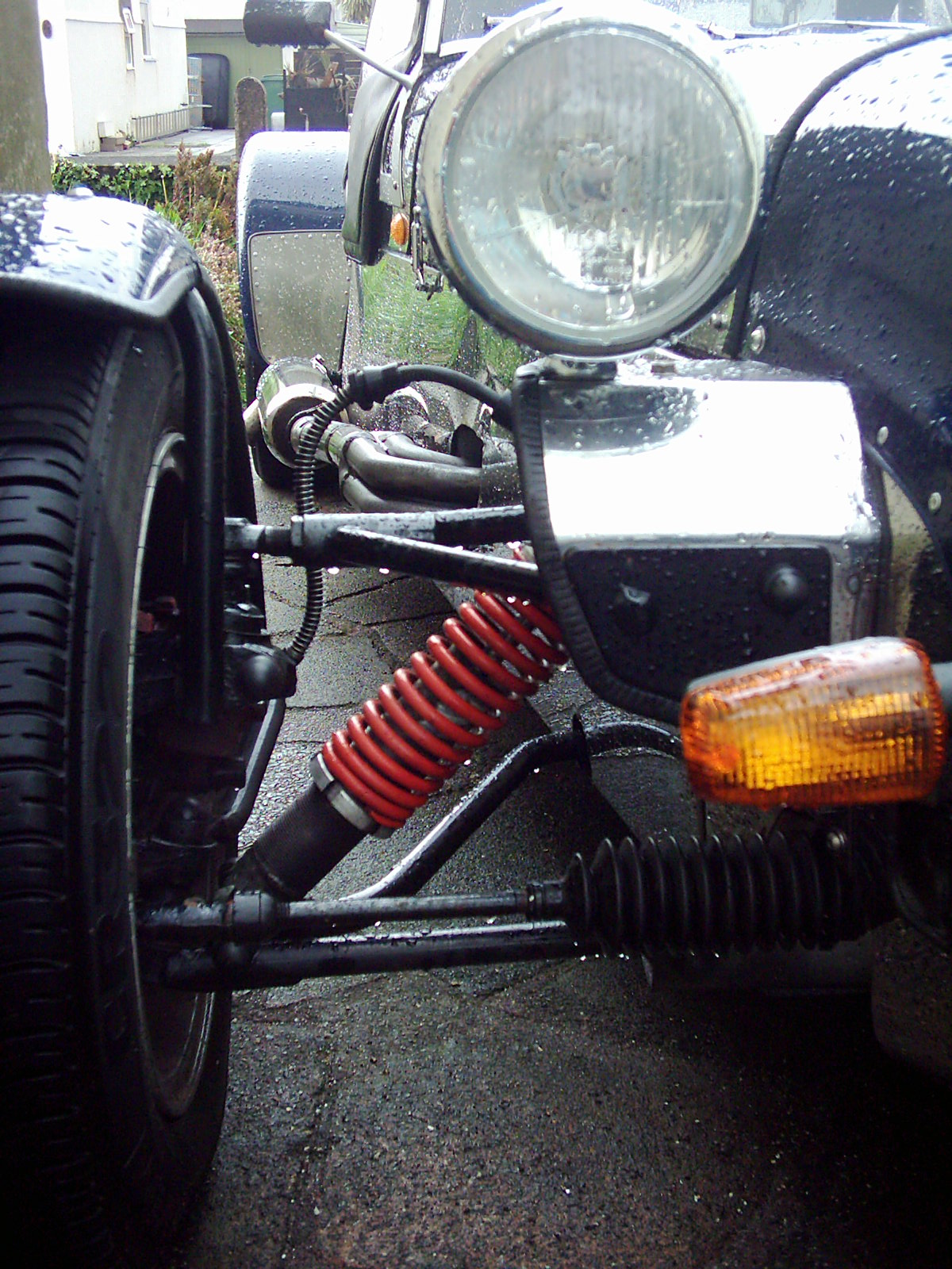

I do not think your car is a Series 3, the front suspension look's more like a Series 2.
This is the front suspension of my Series 3:
As for ride height I have AVO coil overs on the back and the original supplied on the front. The ride height can be raised by compressing the springs more. I increased my ride height by replacing the 14" wheels with 185/60R14 tyres to 15" with 195/65R15 tyres which raised the car by about 4cm and also fitted a shortened sump. Road speed humps are no longer a problem.
