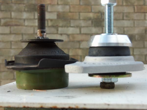

Sorted :D :D :D
The engine mount is indeed from an XR4 / Cosworth, the mount raises the engine about 10mm from the existing soft one and is rock solid compared to the original.
The cloud on this silver lining is the cost :boohoo:
About £140 from Burtons, I managed a small discount when tears started to roll.
I will take photos later and include new and old setups

I have noticed that some Pintos have shock absorber engine stabilisers mounted in such away as to locate the engine, would this be a solution?
Griff
I don't think the mounts you have shown are standard fitment for a XR4 or cossie, they look quite similar to mounts made by a company called vibratechnics, if so they mount the engine really solidly (At the expense of much more vibration - read like being at a dentists). The last set of cossie/XR4 mounts I bought from ford for my 3a looked identical the the mount you replaced and cost circa £100 for the pair.
Thanks
Shandylegs :D :D
You are correct with the manufacturer, they are uprated mounts for XR4 / Cossie use.
