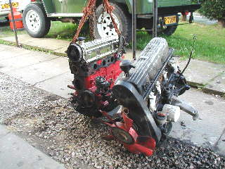

A 1600cc Pinto with the correct carb on will give adequate power. If you know that the engine is a good one, just change the sump (A MUST!) clean it, paint it, and put it in. Why spend £400 or so getting it reconditioned when you can pick up scrap Sierra's for peanuts, should you blow it up, just throw it away and put in another one.
If you go the Raw powered Toyota way, then you will need a very deep pocket. Get hold of their information brochure and start adding it up, just for the 135 bhp engine, with all the bits that you must have, £2500 comes up very quickly.
The red one I blow up on an aerodrome, the other cost my nothing, and is just about to have the various bits put onto it, then it went in.
