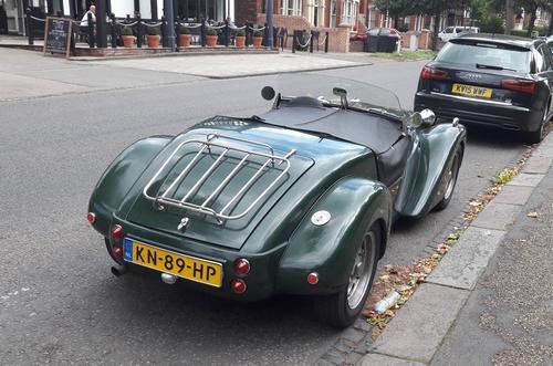

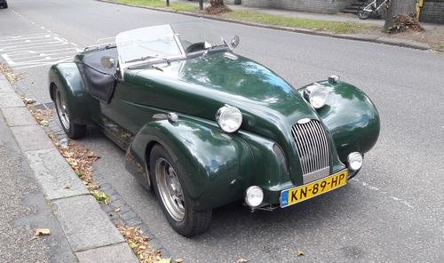

The Burton is a Dutch body fitting onto 2cv chassis and running gear.

Never seen a Burton before - good looking car and love the characteristic 2CV front wheels almost parallel to the floor at lock 🙂
