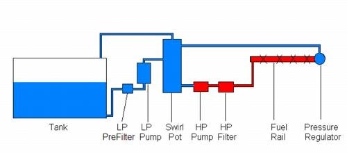

Going back to basics (but I'm still tending towards ignition), can you detail your fuel system. What pump do you have for LP/what LP filter/swirlpot/HP pump/filter/Fuel rail/pressure regulator. Can you draw up the circuits like below (which is mine and fairly typical I think).

Yes, my setup is the same as yours BUT without the HP filter. It was on my list to add last time but then the misfire went, I didn't get round to it. Back on the list, along with new HP lines - mine seem to have very small cracks in them, on the bends. Not leaking but if they're like that on the outside, maybe similar on the inside?
So what I'm sure longboarder is thinking is along the same lines as me - if you're getting a misfire at high revs/high throttle openings, could it be fuel delivery issues. If heat exacerbates it then it could be fuel vaporisation, but otherwise blocked injectors (no filter), incorrectly plumbed system, injector drivers on the ECU, pressure regulator, I mean - wow - it could be anything. But when it's sporadic like this, it's a nightmare! It's one thing when it's in front of me and I can see/feel how it behaves... :)
On a side-note, the Emerald logging only works to a connected PC, you have to run the software at the same time. Would be good to log injector cycle, RPM, throttle position and lambda and identify when the misfire occurs, and see if it aligns with the injector cycle - if there's a very clear relationship between one "boundary" point and going lean - so very repeatedly, as soon as the injector cycle goes beyond a certain value the misfire starts, it would suggest a blocked or faulty injector unable to sustain the necessary fuel flow (assuming your fuel pressure is all good). It's one possible cause, rare I would say but given you're not running a filter in your HP side (naughty naughty) it's one of many possibilities :(

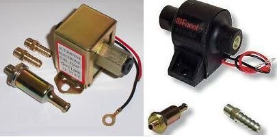

Just to check you are not using a facet style square block LP pump with bullet filter are you? As shown below. These bullet filters are infamous for wierd fueling problems. Pumps are OK ish, used with a £1ebay simple plastic paper filter.
Edited by Longboarder
No, I changed to another filter because I read those bullet ones were crud. Admittedly, mine may be no better but it is physically larger and made of glass so can you see if it has anything in it.
