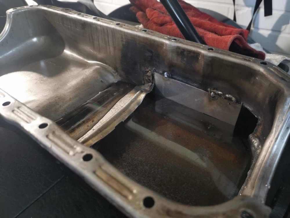

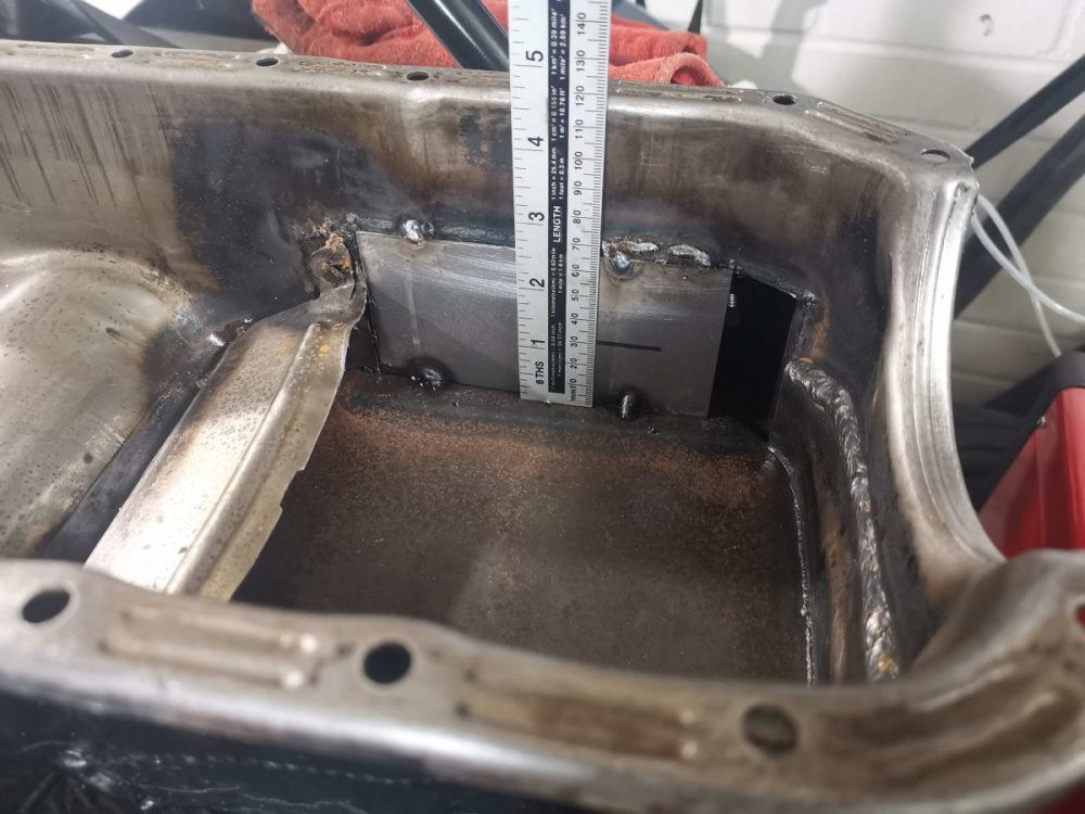

Does anyone know what depth of oil you would hope for in a shortened sump? I have attached an image bellow showing with a pen mark how deep my oil would be if oil was on MAX mark on dipstick.... Seems a bit low to me yet its correct on the dipstick? I have checked dipstick length and bottom of tube to max line distance and all seems correct??

Hydro test - So I wanted to see how much liquid it took to get to the line I drew on that matches the 'MAX' level on the dipstick.... It took 1.5 litres from empty to this bellow image.... Surely by the time the oil starts to pump and the rocker has some oil in it, say 1L or more.... Im left with next to nothing down bellow?
Should the level be bellow the shallower part of the sump like it is? or should that also have liquid in it?
Edited by SFX-Joe

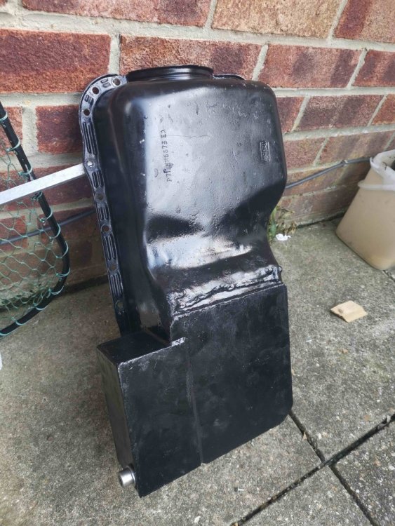

The sump is shortened but clearly hasn't been made wiser to get the capacity back up. Have you got a picture of the outside of the sump to see the general shape.
http://nw.rhocar.org/sump.htm
It has been made wider, behind the baffle is a box to add extra capacity... Image attached.
Edited by SFX-Joe

I have these measurements which according to the pinned post here are correct levels?
I haver a short tube  measuring 24.5cm
With a distance of 12.5cm from MAX mark to tube base
I believe that there are a couple of different length dip sticks but the big thing is the last the max mark should sit at the same height. You don’t want the crank frothing up the oil.
If you’ve hydro dipped the sump then you can work our depth of the dipstick max level against the bottom level of the sump as the sump is removed.
Yes I have done this. So I know that there is 30mm of oil in the bottom of the sump when the oil is on the MAX line on the stick. This doesn't seem much. Keep in mind that's measured when engine is off. Once its running their will be oil pumping around the system and in the rocker, I don't know how much this holds but im going to guess at least 1L?? This will drop the level in the sump considerably in the process?
Agreed, the max height on the stick will remain the same no matter what sump you have otherwise you run the risk of piston slap and forcing oil up the rings causing yet more issues.Also as you say, frothing the oil up. I know you can run a bit more than max safely but that's beside the point. The first pic I posted shows a line which is where the max level would sit.

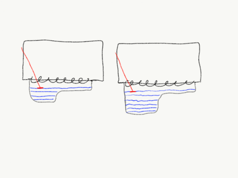

Excuse my awful sketch but I hope this helps some people visualise the who oil level thing... Notice both have the same oil level, despite the sump being shorter or longer. The distance from the top of the oil to the crank should always remain the same, no matter what sump size you have.
The only thing that will change is the amount of oil required to reach the max mark. The mark itself does NOT change.
