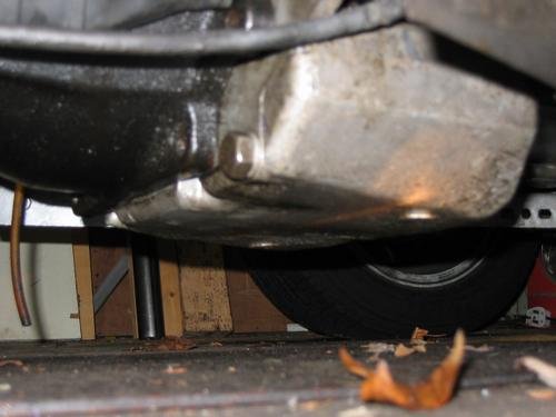

As ohters have said its been shortend too much, here's a bad picture of my RS2000 sump, this hangs below the gearbox. Another way to add capacity would be to fit a big oil cooler, then probably blank most of it off!

the RS2000 sump is safe even if it hangs a few mm below the gearbox, I use them on 2 of my Pinto’s

I did consider the RS2000 sump but I read somewhere that it wont fit with my type 9 4 speed rocket box? The clutch cable or something cant be run where it needs to be on the RS sump due to the design?
