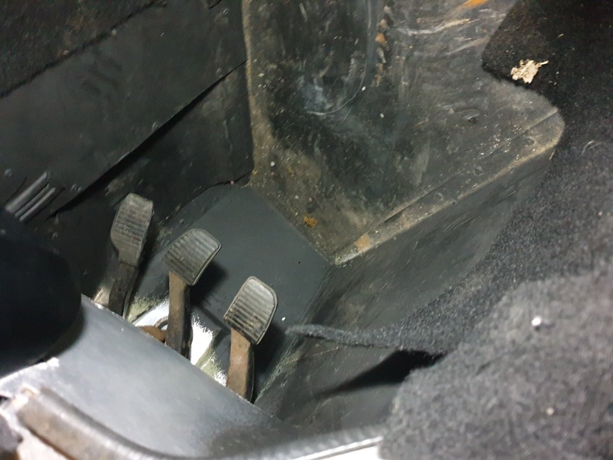

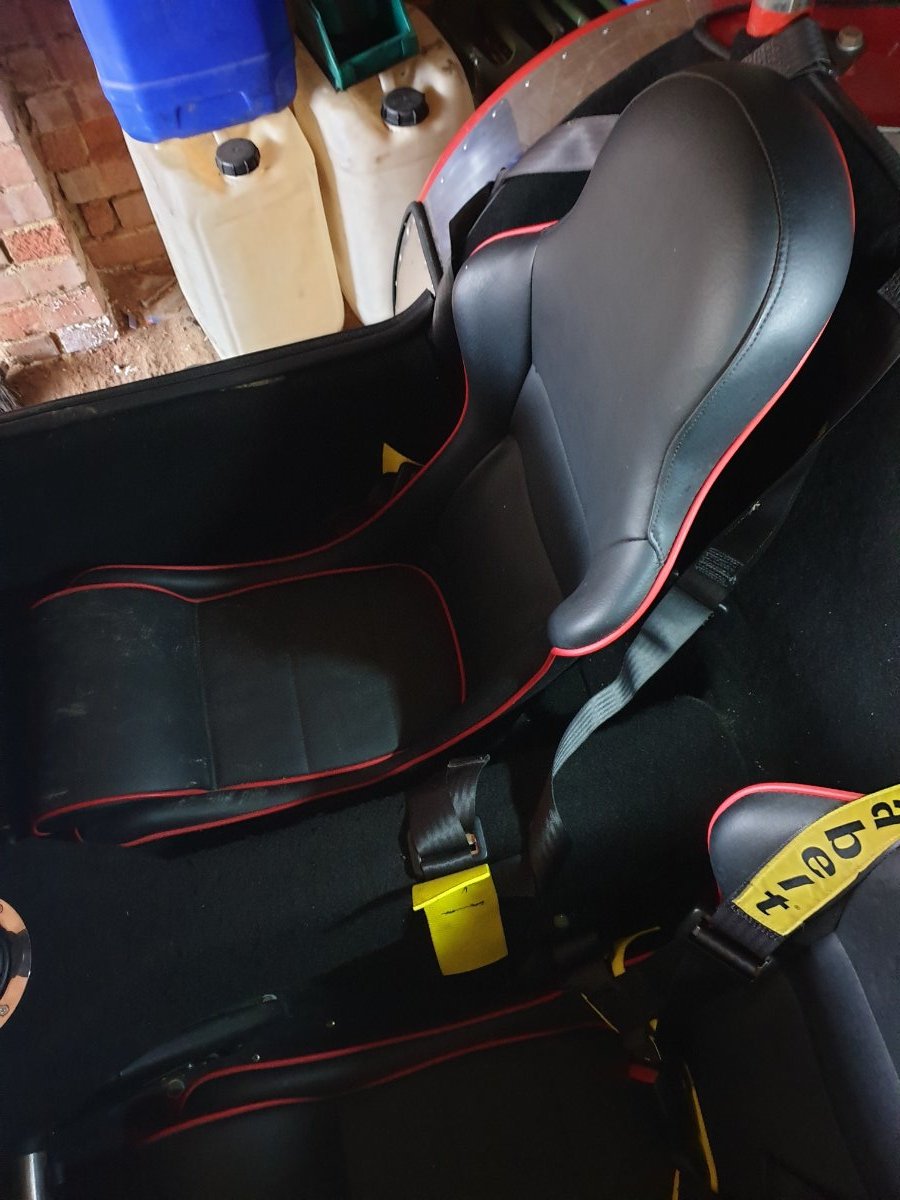

Anyway my 1st priority is to move the seats back and pedals back as the man who built it was tiny and im 6,4. Anyone got any advice on how to do this id be chuffed ill include some pics thanks.
Moving the seat back should be easy & I don't think you'll need to move the pedals unless you have very long legs.  I am 6'1"  and I don't have my seat all the way back in my 2B.  I'm guessing your seats are fixed in which case I would unbolt the drivers seat and see how far back it will actually go - you may need to lift it a tad to clear the rear suspension fixings but it should go all the way back until it's touching the rear panel. If that gives you enough leg room then you would then have to decide if you're going to bolt it back in a fixed position or add runners.  If that doesn't give you enough room then you are probably looking at a replacement pedal box as I don't think it's really practical to move the sierra set-up forwards but somebody else may well have done it - there are some very innovative folk in this club!

Without a servo fitted to the braking system you will have plenty of room for moving the pedals forward, (will need the fire wall re-building) but it seems from your picture that there is already a few inches spare ATM.  The mounting for the pedals may probably need reinforcing any way if the original brackets were used.

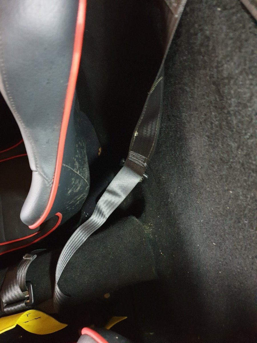

Hi thanks for the advice been in the garage all day today. Made absoultley no progress but what i did do is unbolt the seat then realised it was on runners and the leaver was just stiff. Loosened that pushed it right back then did 4x attempts at bolting it all back up and no matter which way i did it i could not get it to go as stiff and stable as it was orginally. But it was sat on 4x nuts under the runners all differe t sizes so i am guessing they were to level the seat off. Anyway ive done thst many attempts ive knacked the threads on the bolts so need new ones. So 1 whole morning and im 1 step back ha ha
