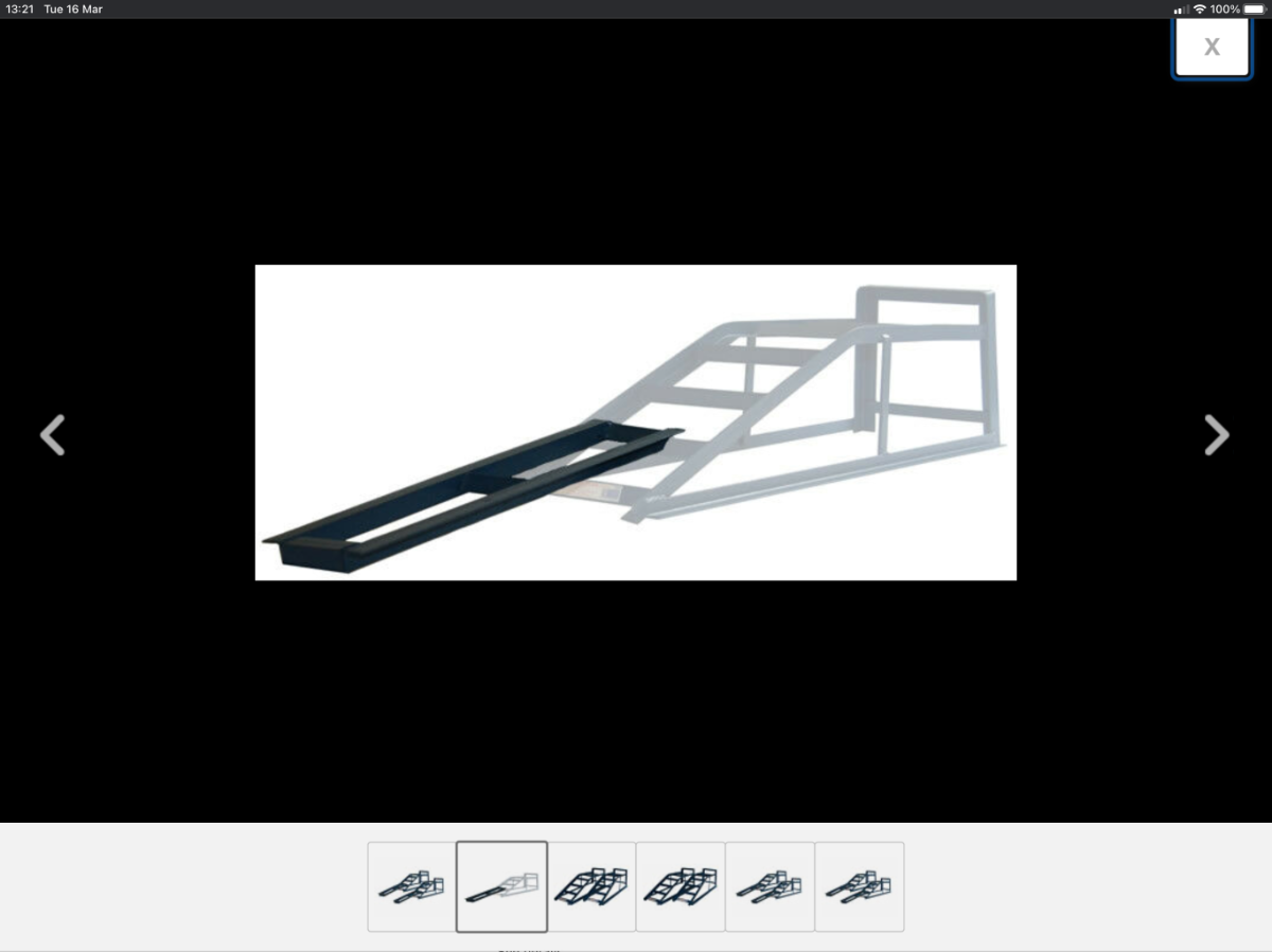

The car is too low to get underneath for the sump plug but I just couldn't get it up in the air. The jacking points are fairly small and I couldn't get my axle stands on them without risking damaging the plastic sills.
Then, I couldn't get the car to drive up my ramps - I had to do it slowly because the front overhang was very close to hitting the ramp but going slowly meant my ramps just slid forward on my gravel driveway.
So that went well...
Have a word with a local builder for some off-cuts of scaffold plank, nail a batten across to engage with the ramps low down.
Ramps onto ramps? 🙂
