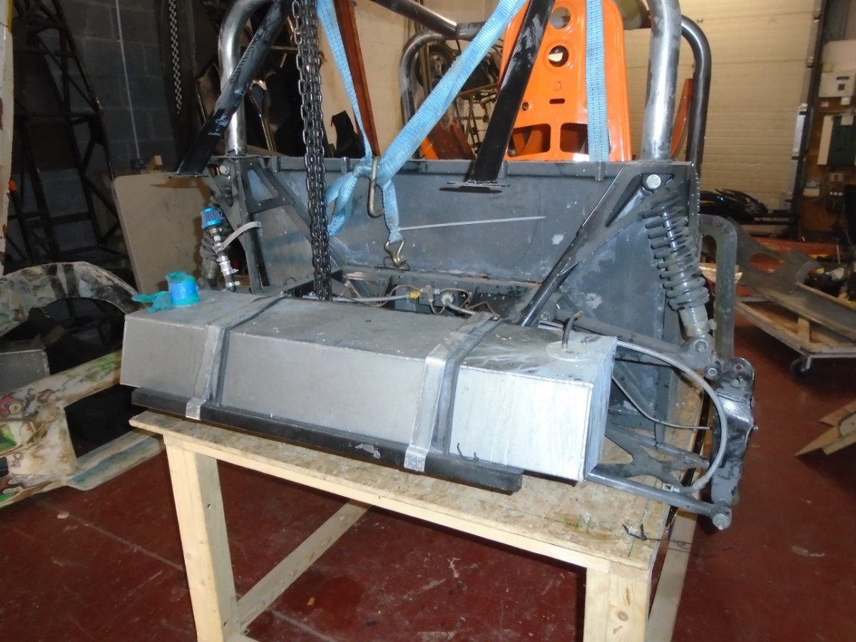

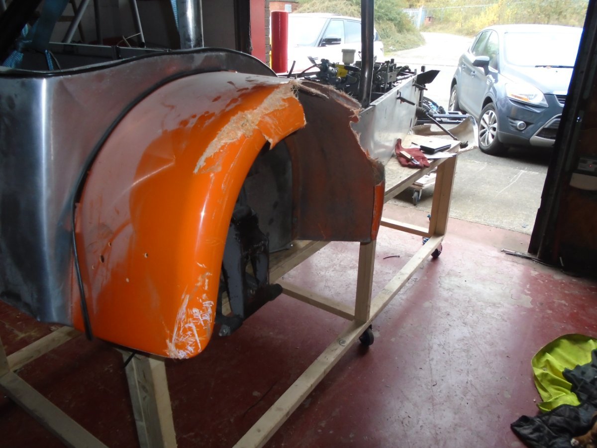

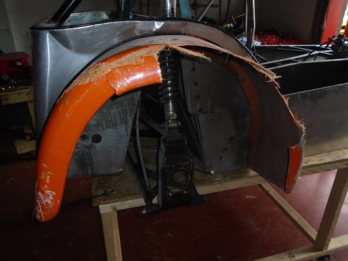

I must be mad, I picked up a while ago a track day damaged Zero. Minor structural, loads of fibreglass damage and some panel dents. I kept looking at it and finally took it down off the wall (new form of workshop wall art)  I said I was not going to build another kit but you know when you start messing taking the damaged bits off it, dam I am getting hooked on doing. Watch this space.

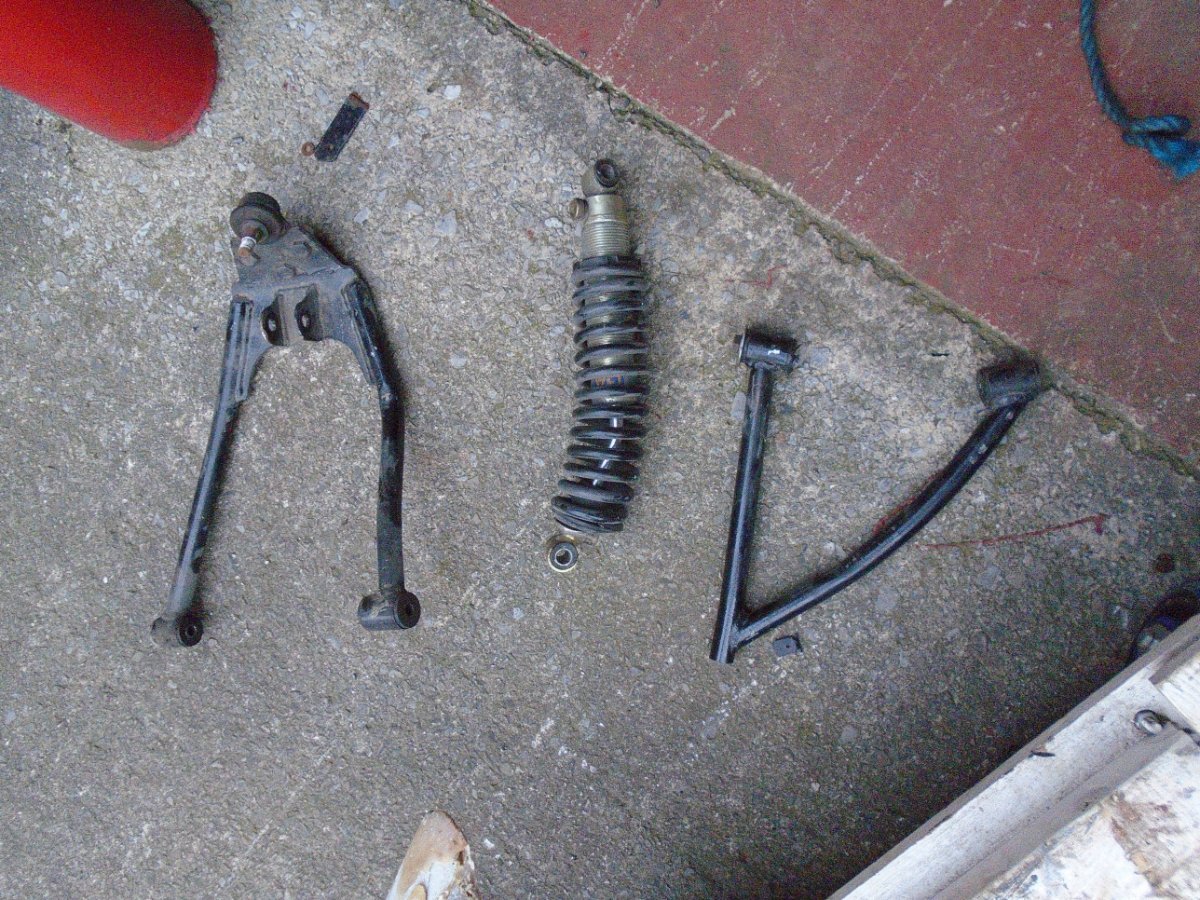

Might not be as bad as that - track day damage, I'm thinking (from the pictures) it's probably spun and slid sideways into something, possibly the suspension arms have been a sideways 'crumple zone' and taken all the brunt? Fingers crossed ;)
That looks like a GAZ shocker. They rebuild worn shockers, they may be able to replace the rod & check it over for less than
a new replacement.

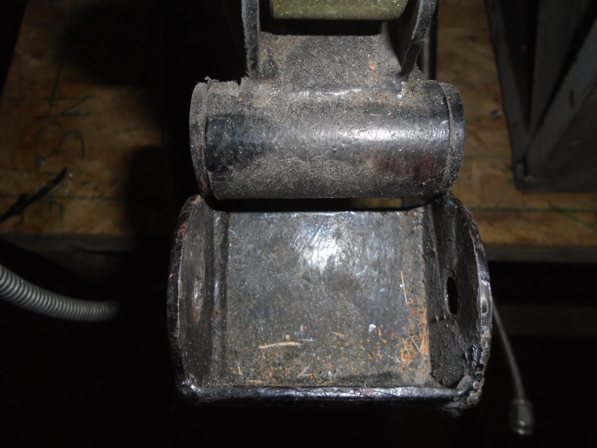

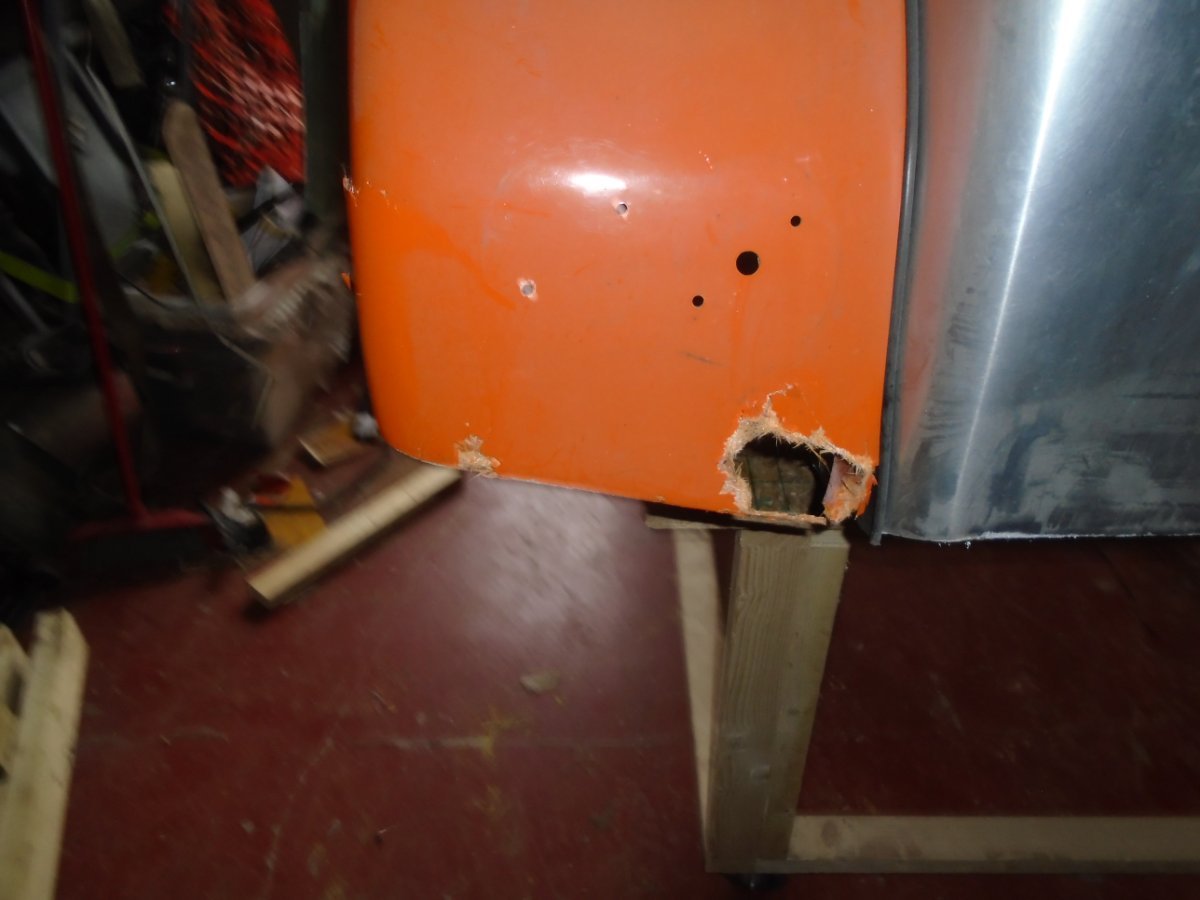

I have just bought new top and bottom wish bones from GBS, got some new coilover in my bits store. Tonight I have pulled the back panel off the frame to flatten the dink on the offside. The frame is straight put lasers on it. It was a cheap buy. The guy who sold it to me had new underwear on when I met him it was his first track day second lap. Bad for him great for me.
The punt is going even better. Took the back panel of and the frame is not touched. The tin work on the panel just needs pushing out. I now think the back took the hit straight on the rear wheel and wheel arch and they absorb the back impact.
