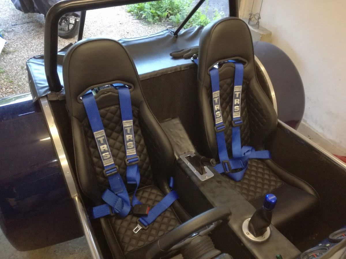

Based on the fact that the seats are the one item on your car you will use 100% of the time you're driving and they make such a difference to the experience (as you've found), they are the one area I didn't skimp on and paid £500 for a new pair from Intatrim.
They fit perfectly with no mucking about needed and I've driven 500 mile days with minimal discomfort. Loads of colour options (I went basic to keep the price down):

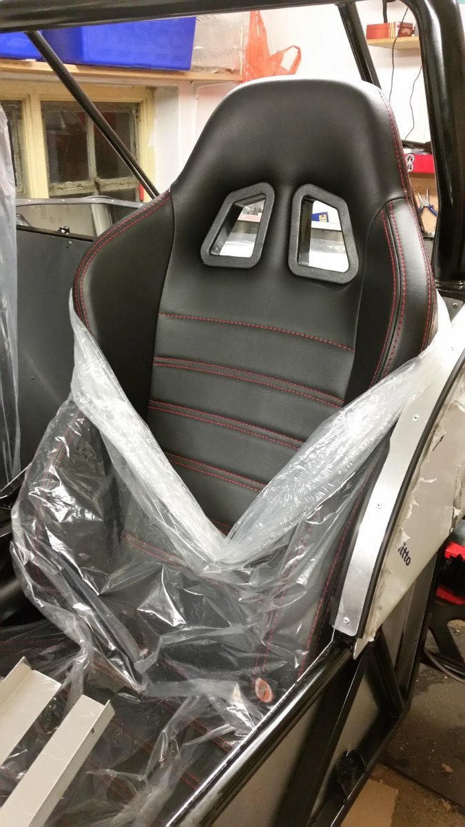

I hope that works out for you - I originally bought some nice comfy seats which JUST fitted into the chassis - but by the time I had added panels, carpet and the seatbelt bolts, I couldn't get the damn things in, even after removing the plastic bits around the recliner mechanism and hacking off the plastic on the handle 🙃
This is on the GT chassis as well...although I think the 2B is pretty big, so hopefully, it will work out. Those other seats (pic below) cost me £250 and I sold them on eBay for £35 😪
