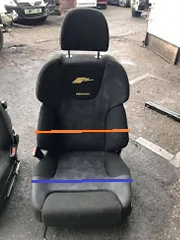

Although the cockpit is quite large (for a 7 style) I found it difficult to get seats to fit hence the mx5 ones. The vectra seats only just fit and because the tunnel flares out there wasn’t much movement on the runners and you couldn’t get your hand down the side to adjust the backrest.
Maybe Alan can measure his seats as I sold my car last year (still got a 7 style though)
I agree they are a tight fit, and I hadn't realised how many adjustments they had until I took them out.    The relevant measurements are 18" for the blue line (touches the tunnel on the inside and is about 1" clear of the chassis on the outside) and 20" for the orange line which touches the tunnel and the top rail so is the limit.

I live just outside Wellingborough in Wilby. It would be great to meet up if you are over this way, Wollaston is only 4 miles away. Thanks for the seat information, the Sparco R100 are quite a narrow seat so should fit.

I will need the seats to work forward and back on their runners as the drivers of the car will vary in height. Demon tweeks assure me that the Sparco R100 will fit ok but the seats can be returned for a full refund if they don't.
