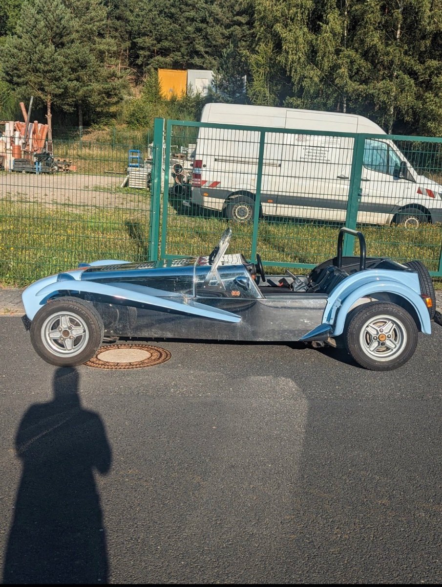

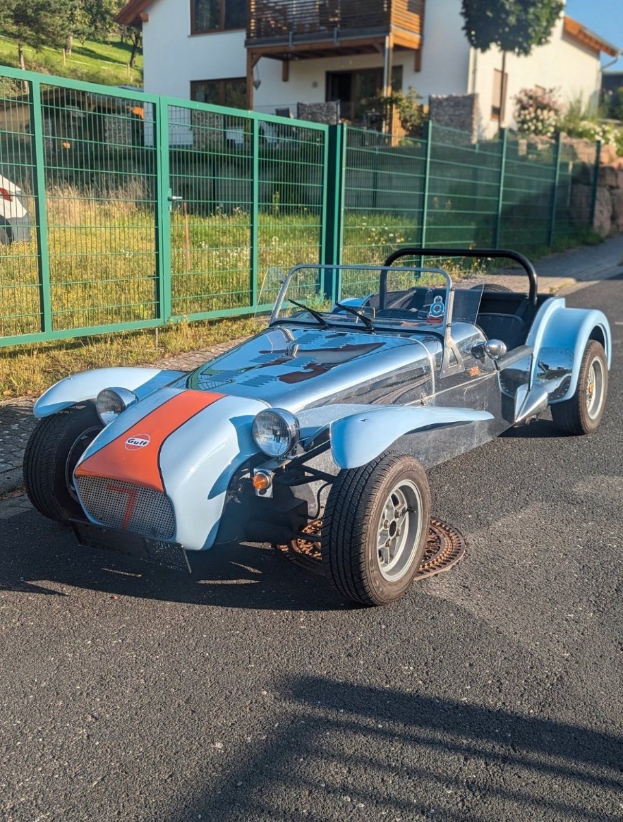

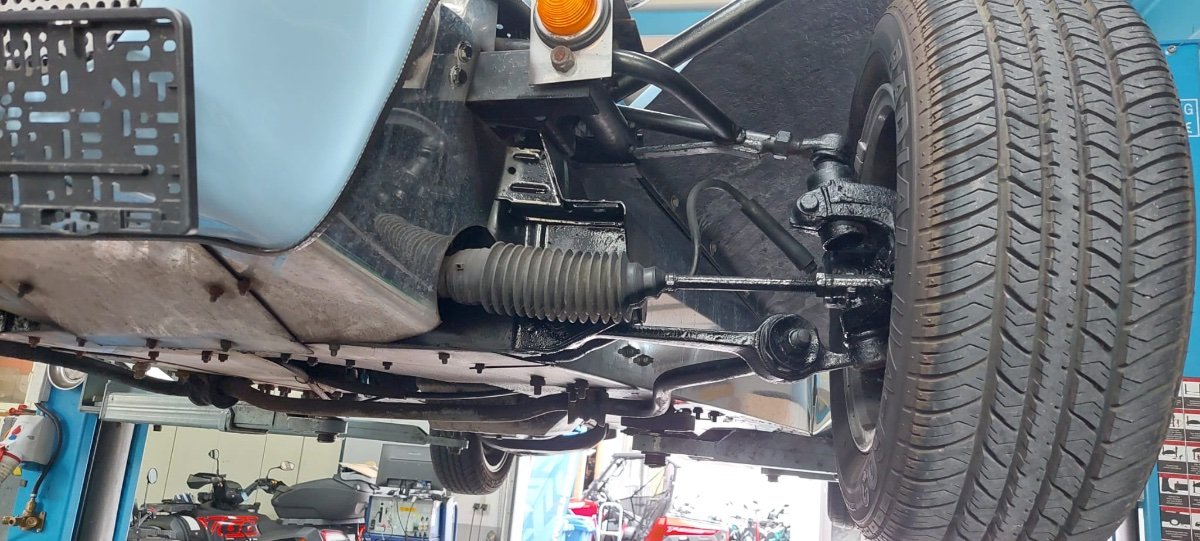

1. what series is the car itself. I think it’s based on the sierra (by looking at the identification pics). Not sure though.

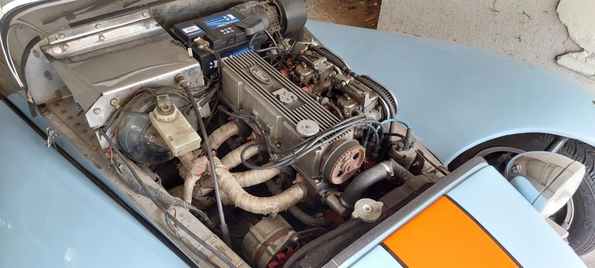

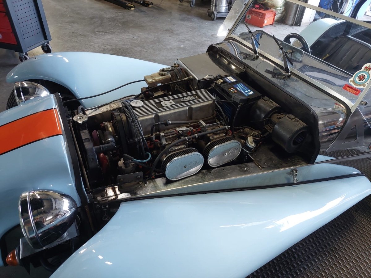

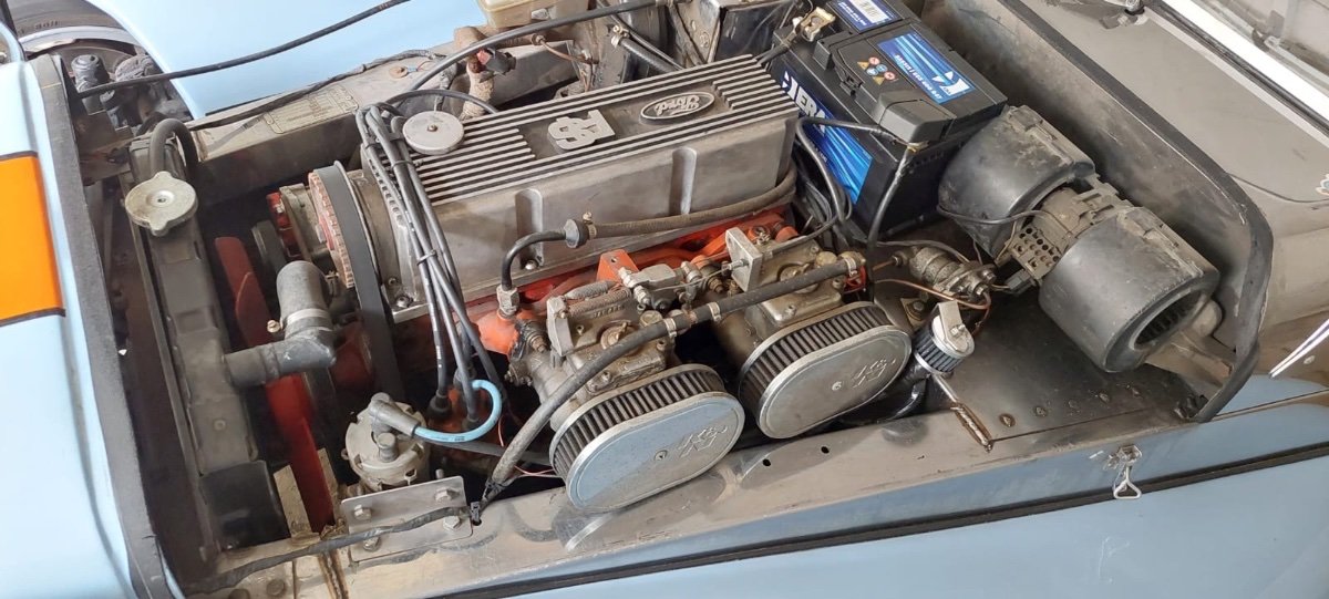

2. Can anyone identify the engine from the pics? Or how can I identify myself? Want to change the cambelt as a precaution (and maybe the cam oil feed pipe)

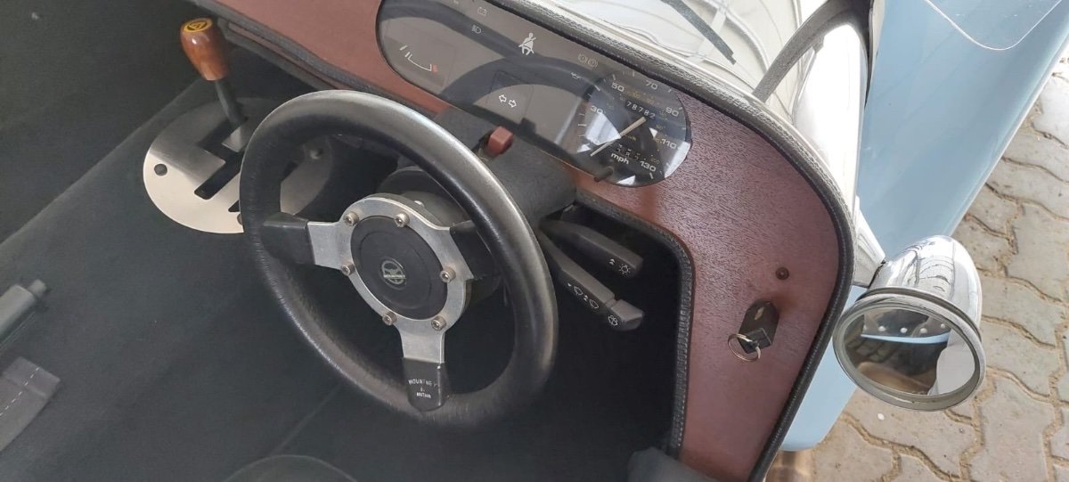

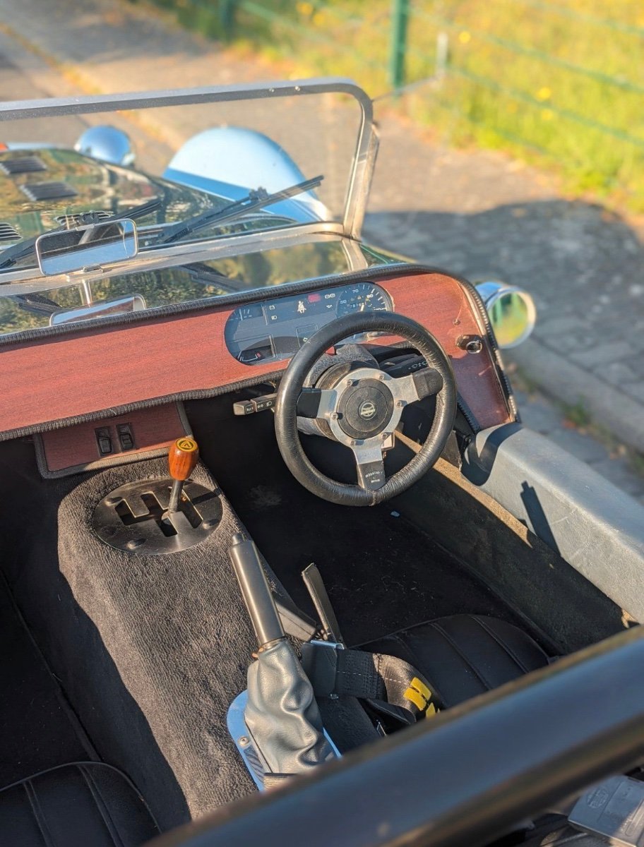

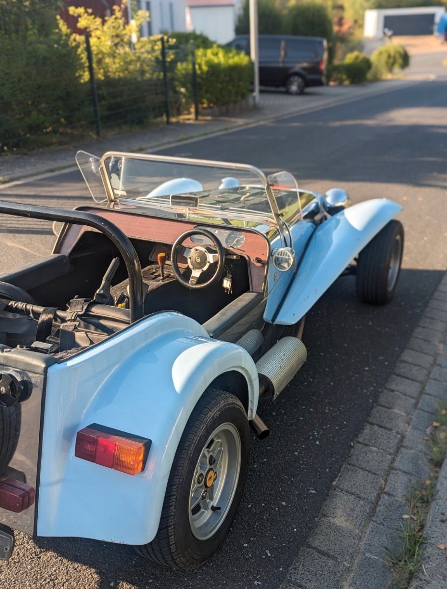

3. The dashboard leaves a lot to be desired 🙂 would like to update it also with new dials etc. any tips how to go about this? What materials are best? What instruments are recommended and where can I get them?

Forgot a question 🙂 According to the official paperwork (and it doesn’t get much more official than vehicle paperwork in Germany), the power output of the engine is claimed at 105kW which is 143PS. And that from a claimed 1593cc engine.
Now the question: is that even possible?

It looks like an S3 to me - have a look here - https://nw.rhocar.org/htm/identification.htm       The clocks and stalks look like Sierra to me as well.
Options for re-doing the dash are probably as numerous as the number of cars built.  Have a search on here & you should find lots of picture and info. on instruments and dash.  I would take your time, study a few designs and mock them up on your car to make sure you can see everything before you decide.  There is little worse than making and fitting a nice new dash panel only to find that you can't see the petrol gauge when your hand's on the steering wheel.  (Don't ask how I know).
That engine looks like a Ford "pinto" to me, quite possibly from a Sierra.   Have a look on the side of the block, there should be numbers cast in the side which give the engine size.  Earlier blocks had 2 digits, later ones 3.    16 or 16x is a 1600, 18 or 18x is an 1800 and 20 or 20x is a 2 litre.   The "x" digit is an indication of the construction of the block.    I would say the power figures you've got are about right for a tuned 2 litre.

It is a narrow tub sierra based S7. The clue is the trumpets covering the end of the rear subframe just in front of the rear arches.
It uses the sierra front subframe which makes it Mark 1 Sierra S7. So the kit dates form 1994 to 1996.

Thanks for the analysis IanS. According to the list on the rho site, the years you mentioned bridge the Series 1 & 2. Your thinking is that it's a series 1 though?

Yeah I wasn't sure on the model based on the pictures. I thought it was a series 2 but I guess I'll be able to a bit more digging when I've actually picked it up next week. IanS gave a few more pointers as well with respect to the side pods.
With the dash layouts it's all a bit overwhelming as there are so many great looking examples out there but thanks for the advice on mocking up, I'll definitely be doing that.
Will also check the engine for any annotations to see if they match. The rocker cover was throwing me a bit with the RS and especially the claimed figures. The normal pinto 1593 would be pushed to get 143ps out of it. Looking forward to the investigation though.
