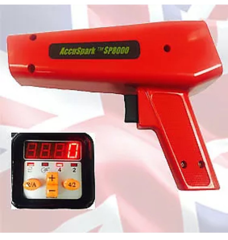

I have got a timing light but ain’t got a clue how to use it the old saying “all the gear no idea” and got electronic distributer
