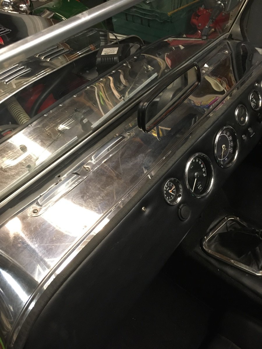

  2. For those who were interested I carried on the conversation with Spare part over messenger but this is the gist of it. do they work? Honestly not sure on that count, we don’t have any wet weather gear at the moment so have never been in the situation of having them steam up. Though we do get a good blast of hot air out of ours. I will be working on the car this weekend so I’ll make a note and get you a picture of our set up but I think they are around 2-3 inches away from the base of the window. You will see on our picture we have 4 demist vents but actually only two are connected (the other two covering badly drilled holes from earlier in the build. hope this helps

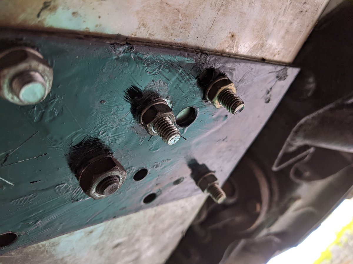

  4. Fail 6. All bolts under the car must have nylock nuts or split washers. We bought this car assembled and the guy that built it did not put any on. This seemed like a simple fix, but he had used steel bolts and after standing for twenty years were rusted solid. To stop them shaking loose we had to use a three foot bar on the socket to remove them, and in some cases had to grind them off. It seemed uterly pointless, but the regualtions must be followed. The retest is now in November 2020, so missed another summer. WE will let you know how we get on.

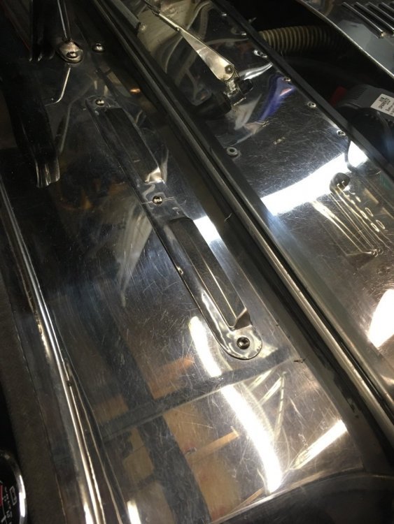

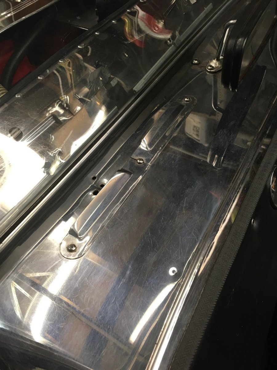

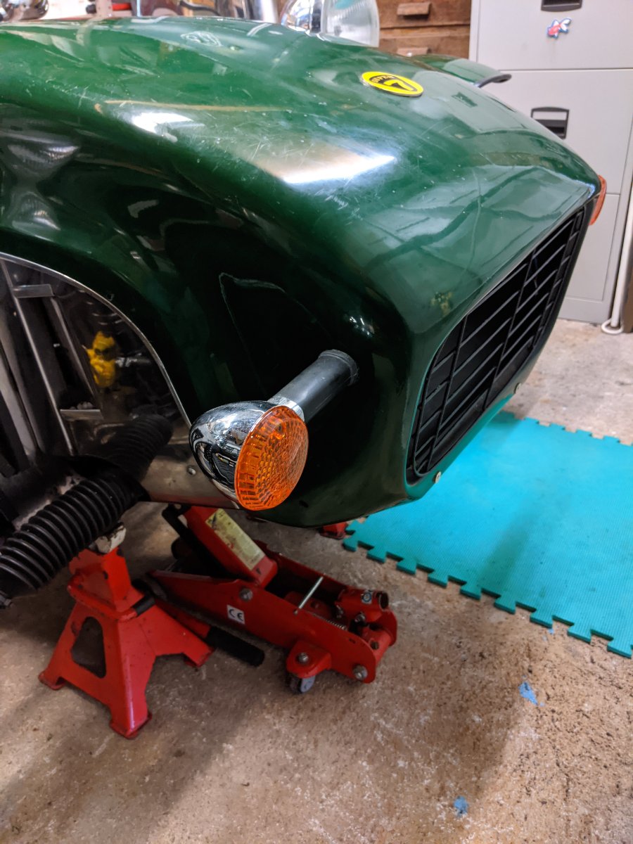

  5. Fail 5. Front indicators. Although we had fitted side indicators on the cycle wings they still insist that the front ones on the car can be seed from the side angle. WTF? When we bought the car they were already fitted to the butress, and othe Exmos I had seen were the same, so we missed this. He said he wanted them moved to the nose of the car. Club member Graham curtiss suppied us a pair freeof charge. See pic.

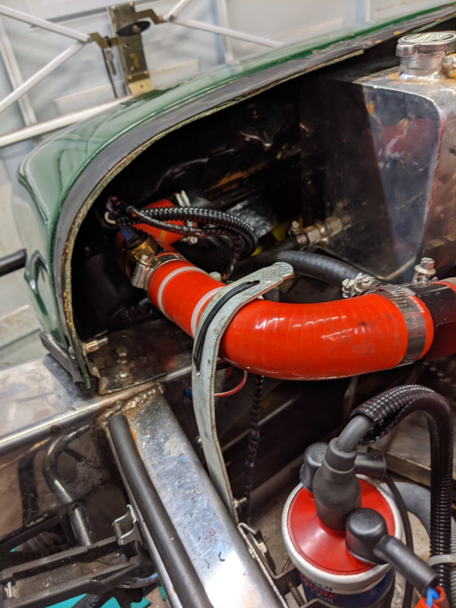

  6. Fail 4. The upper red coolant hose needed to be supported. See new bracket.

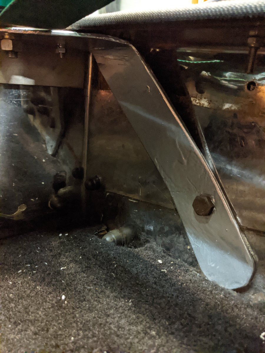

  7. Fail 3. Again seatbelt mounts. This time the centre floor brackets needed to be larger. We had made them two by four inches and he wanted at least six by four. Pic shows the new larger bracket fitted.

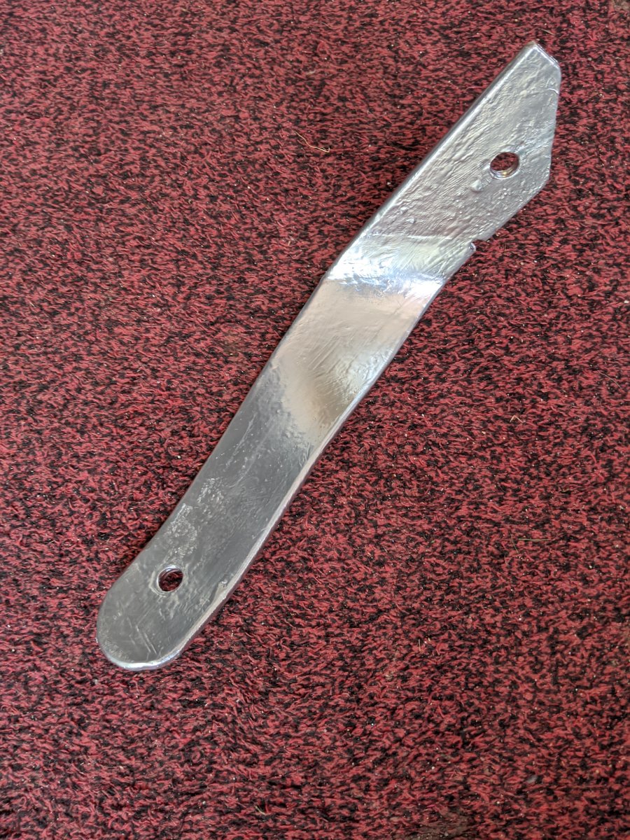

  8. Fail 2. Seat belt mounts. We had fitted a stengthening bar across the width of the car, under the top lip of the upper section of the boot. The four point seat belts were fixed to this. He wanted the bar to be attacched to the upper suspension brackets as well. We fabricated the brackets, here you can see one we made, and again fitted to car.

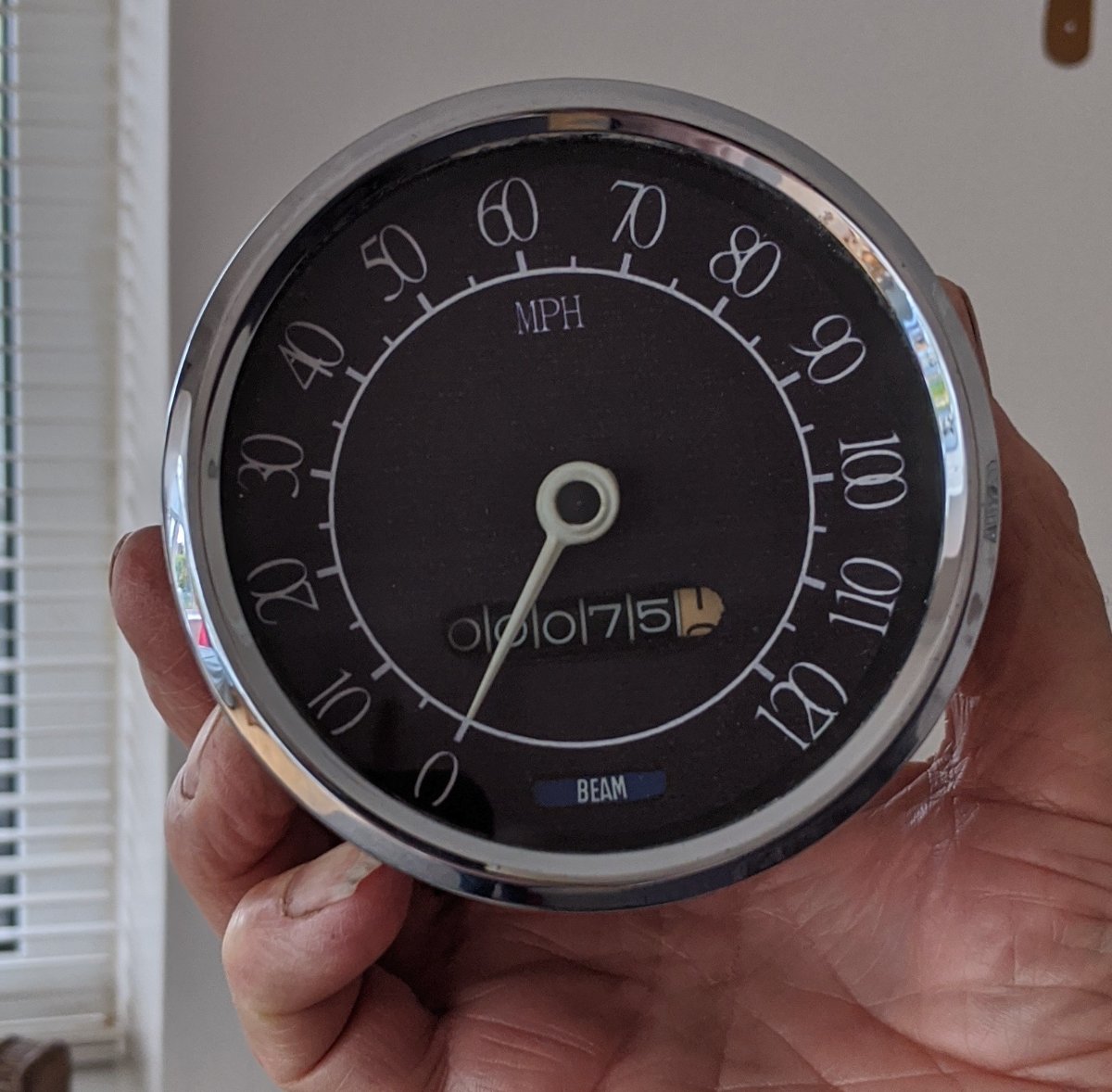

  9. So, as we feared the corana virus put a stop the the IVA centres checking out the cars. we had to wait until the end of June for the test. We took it to the Exeter center and our hearts sank as the inspector told us he had only ever passed one kit car first time , and that was someone who worked there and had seeked his advice all the way through the build. IT FAILED. Although he was very complimentary on the work we had done, and said the fail list was very short and we should be proud of what we had done so far, and he should be able to fit a retest in within a mounth. Ist fail. The speedo we used was a smiths one from an old fashioned type that came from a ford 1600e Cortina. The gearbox was a sierra. The speedo failed the speed test because the origional wheels were different sizes. It was reading slow, so wheen the vehicle read 70 mph, it was actually doing seventy eight mph. We thought about changin the speedo but could not find one in the old smiths style. We got round the problem by recalibrating a new face for the old speedo and printing it out on Photo quallity paper. We postiond the 70mph on the point where the old 80 mph was. This gave us 2 mph leaway, as they are not bothered if the speedo reads fast, just slow. See picture of modified speedo.
