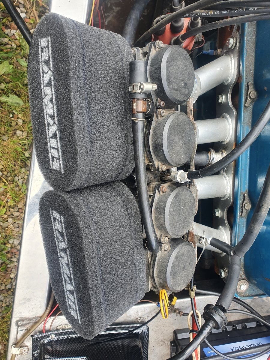

    Thank you for you thoughts and suggestions. Had a good run this morning and much smoother. Exhaust backfiring occassionly but I think thats just cos I need a regulator in. Got some different hoses to try so hopefully be getting some trouble free runs soon.

    Ok had a quick look tonight, astonished that the hoses from carbs to manifold were looser than the proverbial at the back of the tavern. Tightened them up car fired first pull and balanced the carbs with a vaccum guage. Getting late so turned off for neighbours but to my annoyance hose clips slipping away again. Prehaps the slippery fancy silicone hoses are useless for this job?

    Ordered a regulator Yes I have distributer vaccum and brake vaccum T'd into inlet manifold. Borrowed a vaccum guage so I can balance properly I've read that the mixture on these carbs are factory set and the screws are covered with welch plugs. Does this mean I should just leave them be after balancing carbs properly? I havent done anything with the timing as far as I'm aware. How would I check this? I'll report back when I've fitted regulator and balanced carbs

    Thanks folks can you advise of supplier for regulator? Got fired up again and my father in law a good mechanic advised two were running lean and two rich so imbalanced. I think I know how to balance properly with a vaccum guage but how do you adjust mixture?
