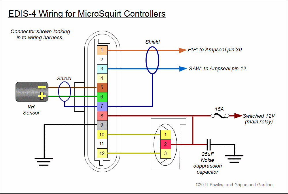

  2. Hi Chris I have just finished the refurb on an s7 with a duratec (just a zetec with VVT) using the trigger wheels ecu and the ford edis unit (module) you refer to and it worked first time and really well if you have questions then please let me know, the attached file is for edis 4, i have a full wiring diagram for the microsquirt on zetec if you want that just give me a shout. Cheers Andy
