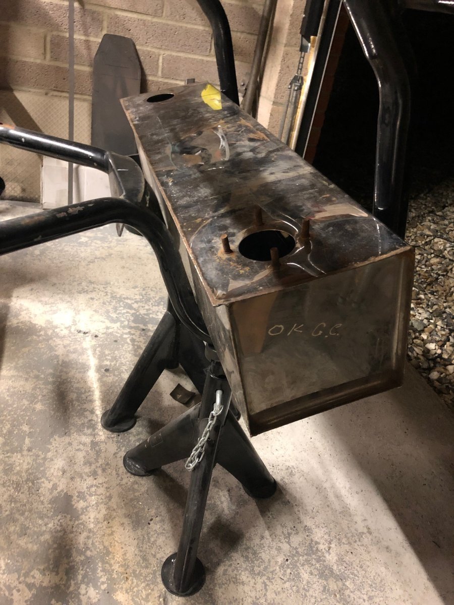

FYI - A couple of years ago I acquired two different original stainless Robin Hood tanks with the hope of using one on my 2B build. One of these was identified by other RH owners as the same as used on 3A and S7 models and I guess is the same as what you have on your monocoque car? nominal dimensions approx 8 x 8 x 34" with horizontal flange upstand. This compared to the 2B tank that was slightly taller but narrower (6 x 8 x 33.5" with vertical flange upstand).
The monocoque tank (long since sold I'm afraid) is shown in the attached photo, sitting in the back of my 2B chassis. If there is spare height available in the back of your car then I would suspect that a tank made for a 2B would physically fit, but may present issues with routing the filler neck.
In the end I used neither tank as I found I could (just) fit an aluminium MK Indy tank in the 2B, and I wasn't convinced about sealing the filler neck on the original RH versions.
