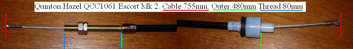

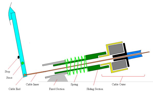

When I fitted a floor mounted pedalbox and lost the sierra one I got the rattle. Adjusting it out on the cable never seemed to keep it quiet for long. I made a sliding section incorporating a spring to retension the cable. It also helped that I switched cables to an escort one that had an adjustable length section in it

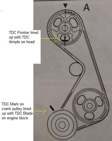

Rev counter sounds OK. That missfire sounds like 3000ish rpm. I believe you have found the problem. Cam timing shown seems way out by about 30 crank degrees advanced!!! I'm surprised it runs at all and has not mangled all the valves if that is a true picture. It looks like the cam belt has jumped two or even three teeth but its also possible that the crank or cam sprockets have slipped on their respective shafts. The cam belt tensioner and the belt must also be in the suspects mix. I would also say you risk the health of the engine if you drive it hard or even if you drive it!
Personally I would say get on ebay and get a new 'Gates' brand cambelt and tensioner as a first step. Like this https://www.ebay.co.uk/itm/FORD-PINTO-2-0-OHC-Cam-Belt-Tensioner-Genuine-GATES-INA/162992978179?hash=item25f3237903:g:4DoAAOSwXshWq660 Next have a good look in Haynes and enlist the help of someone who knows this stuff. Probably need the radiator out, hoses off the front of the engine and alternator belt off to help access then strip off both cam sprocket and crank pulley and the toothed sprocket behind it that drives the belt. Reason I would remove the pulleys is they are keyed onto their shafts and should not be able to slip. Indeed it's extremely unlikely that they have slipped but the cam timing is so far out I can hardly believe the engined hasn't lunched on its valves if it's genuinely that far wrong so I would want to confirm the woodruff keys are still properly in place holding the pulleys/sprockets in their correct positions.
Then it's a case of putting it all back together, lining up the cam, crank and dizzy at TDC and putting the belt back on and tensioning it. I would say this is a delicate operation. Not difficult but an experienced helper would be almost essential.

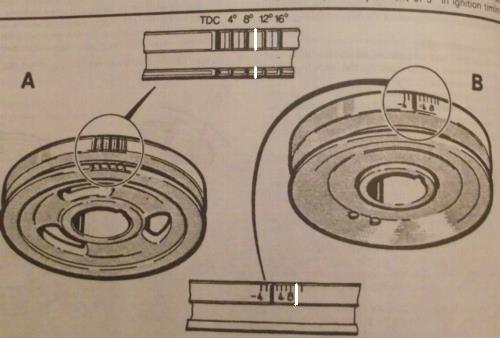

Before you do your test run set the distributor timing to10deg before TDC as a good starting point using the strobe at tickover. Also do the pump test. Then your can wire up the temporary ignition supply and go do your drive test.
Below pics of the crank timing marks. Two types of pulley you might have. I would put a blob of white paint/tippex on the marks you want to use and the blade as shown to make life easier. The pulley is as you would see it from standing in front of the car facing the windscreen.

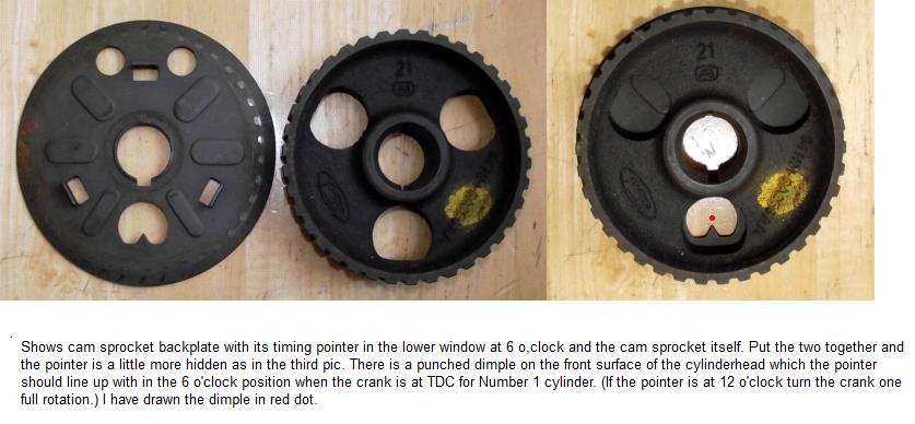

Cam timing. Much less likely problem but worth checking. Need to take the belt cover off the front of the engine so you can see the cam pulley. Then just turn the engine using a spanner on the crank pulley nut (or even rock the car in 3rd gear to turn the engine) till the pointer in the cam sprocket backplate is at 6 o'clock exactly and lined up with it's dimple. Now look down at the crank pulley and the marks should show top dead centre lined up. The pics explain better. If the cam timing lines up to within 3 or 4 degrees then this is good enough for now and not your problem.

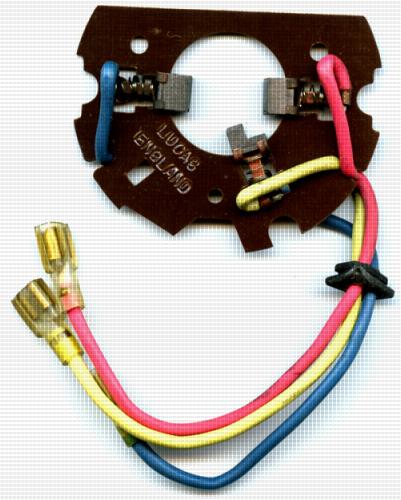

There are three wires (BlueRedYellow) from the motor into the back of the cam operated park switch which is clipped to the motor casing. Five wires into the park switch from the car loom, four from the wiper control switch and one from either ignition live or battery.

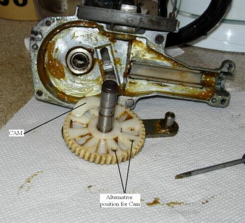

Pic below of some of the innards. Outer of cable has a flange which holds it in the motor case. Inner has an eye which is held by a pin on the piston driven by the big wheel. Pic below. Side plate has to come off the case for disassembly.
The motors are reliable. The park switch on the motor is usually the problem if the motor was parking and then fails to park. If it's never parked it's wired wrong. If the motor stops working it's usually the brushes worn. These can be bought separately. There could also be problems with the column or dash switch but Hey you're already depressed enough.

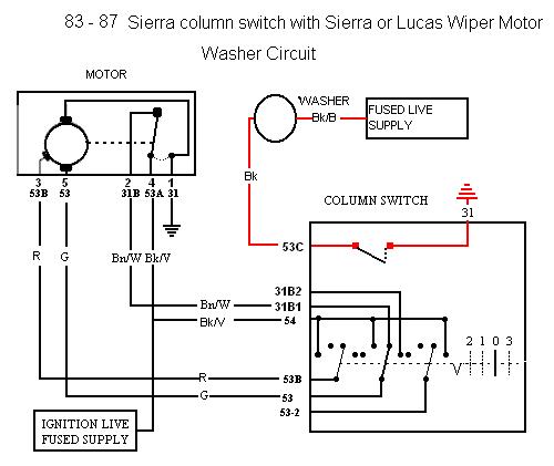

83 stalks are designed to connect from terminal 53C on the column switch to one terminal on the washer motor and provide it with a switched earth. That assumes that the washer motor also has an ignition live supply connected to its other terminal. I don't know the premier loom wiring but remove it from the washer and from terminal 56C if it is connected there. Then give the washer an ignition live and run the other terminal to 53c on the column switch.
Your 83BG stalks should not have a W terminal. If they do then they are 87BG stalks or later!

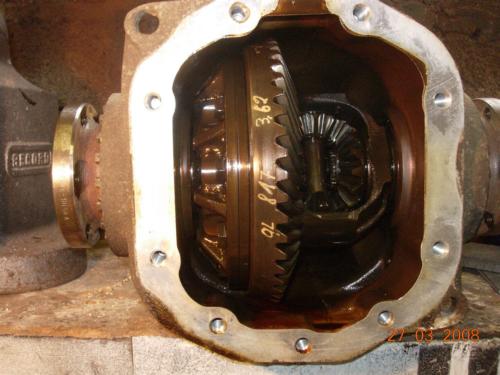

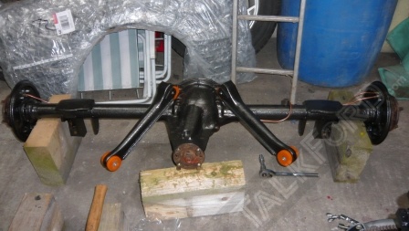

Sierra diffs are pretty tough, as is the whole backend running gear and it all works pretty well. The drums are also fine for use and much less trouble than changing to sierra discs or MX5 items. Sierra viscous LSDs are available and work well. They may be a little tired but it's a much lighter car than the sierra so detuned by wear to match its new installation. Add in decambering wedges and the rear will work well for very little work or expense. (After market LSDs are also available.)
All sierra diffs have their ratio on the crownwheel in white paint so easily read if you take off the cover. Mines a 3.62 LSD.
