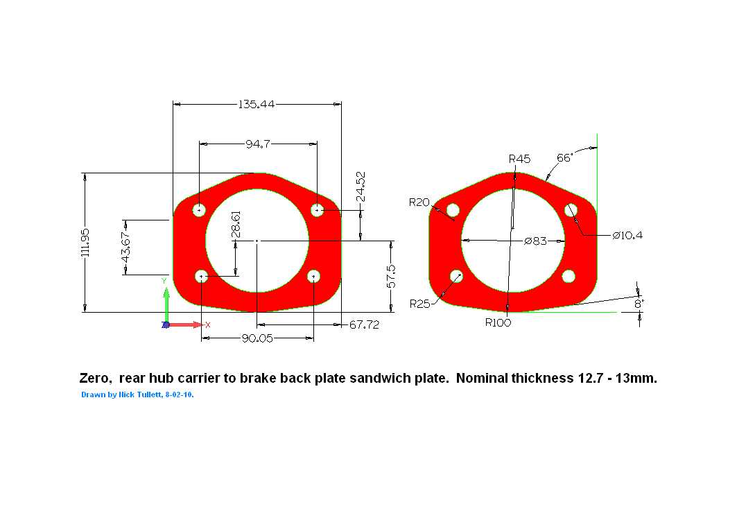

  4. Hi Yanto, ( and also anyone who can make use of it ) Please find attached a dimensional drg of the rear hub carrier sandwich plate or spacer that i made for my Zero. Hope it will be of use to peeps and save you having to use those waste of time flame cut (badly!!) steel, err....... things! LOL. If anyone wants it, i also have a 3d Cad model (IGES file) of the same part if there's any CNC machinists out there. Cheers all, Nick

  10. PMSL, yep, the ones supplied where, err......... err......... utter bo##ox to say the least. I threw them in the bin as i unpacked my kit, never seen such crap!! Sorry, ranting now!! I've got a Cad model of mine on my PC at work, so i'll do a dimensional drawing for you mate. If i load it on here, it should benefit all if they want to make some. HTH, Nick.
  11. Hi J, I made a one piece spacer, 13mm thick, and the bolts i used where M10 x 35 long. Used Nylok nuts also. HTH, Nick.

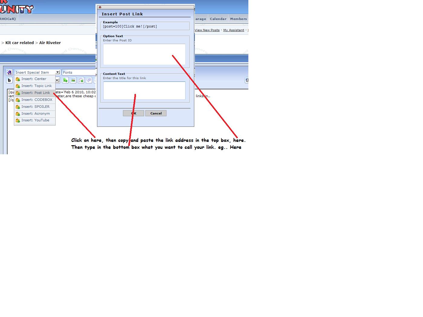

    Hi badboy67, Hope this helps with posting links mate. Regards, Nick.
