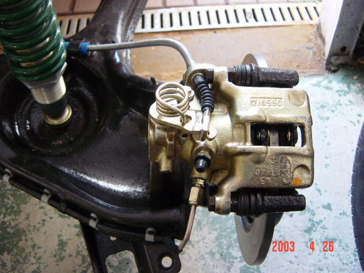

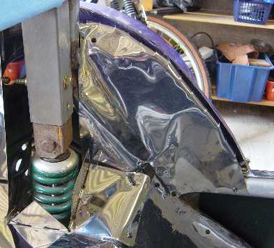

  12. Yes. Use the sliding inner section of square tube in the chassis, and attach the top of the shock absorber using the bolt supplied, like this: The other end of the suspension is mounted through the existing hole in the semi trailing arms, in the middle of the cup where the spring used to sit in the donor. Robin Hood supply a set of rubber bushes that pass through this hole, and screw onto the end of the shock absorber. It's visible in the top left hand quadrant of this picture. As far as I know, this arrangement is the same as the normal 2B, so I imagine some of the other members have other pictures. Cheers JonB

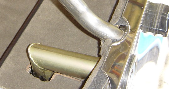

  13. Just be grateful it's not the old welded elbow type. Here it is, awful thing. I had mine plated (it's the gold pipe). It takes ages to fill at the petrol pump, due in part to the elbow - the fuel fizzes up and blocks the pipe for long enough to spit fuel back at you. I htink Enforcer's is much better with the flexi pipe.
