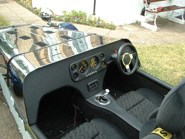

This is my dash which is made from standard hardboard. Its covered with 1/2 inch of foam then vinyl. It uses the standard seirra clocks and also the heater fan switch. Costs hardly anything as hardboard is cheap and the vinyl is only $5 a metre. Ive used fixings on the back so you cannot see any screw heads etc from the front. hth

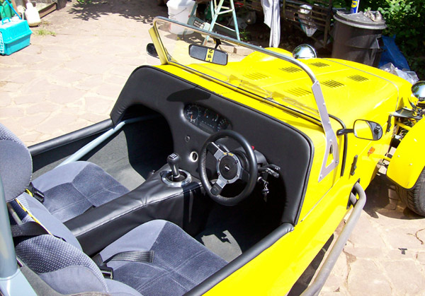

Here is my attempt using plywood coverd with foam and leather cloth and a set of capri gagues.

daniel how did yoy make the bezzle work
it appears nicely rounded, but ther one i have is pasrt of the mainm dash and ant rounded off
i mean on the edges by the way.
looks good and should pass sva.
regards graham
Guest Daniel Aldridge
Hi Graham,
I have no pictures of how it was made and it passed sva no problem. The lower dash had another two layers of ply glued behind the bottom edge and then shaped and rounded off before I coverd it in the foam and leathercloth.
The clock surround was made using ply cut to the shape of the capri clock bezel and the holes cut using a fret saw and then sanded the edges.
Danny

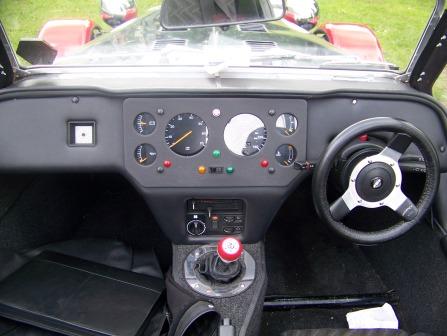

My attempt Triumph Dolomite for the grand sum of £10.00
Been on now for 4 summers.
On the new list for "tinceritus" winter 2008 needs tidying up a bit.
