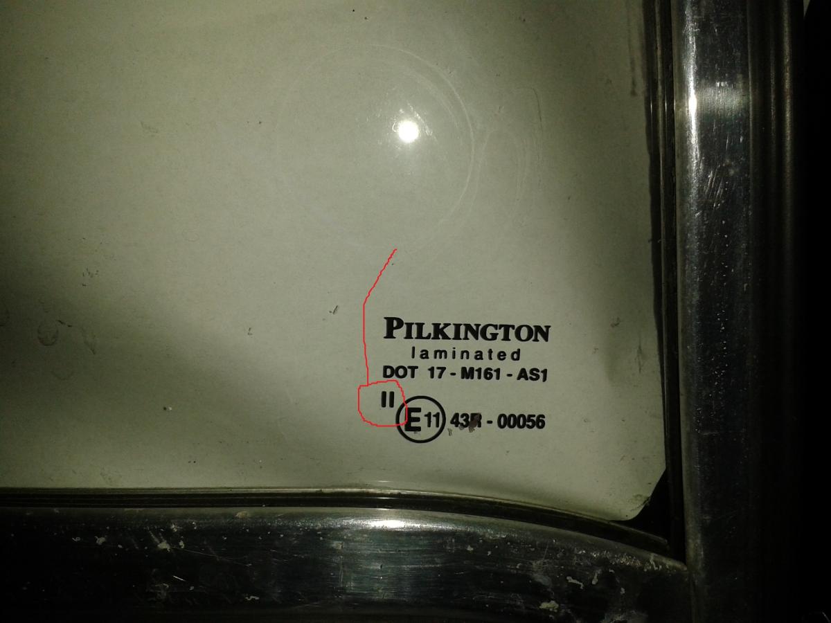

If you are putting it through with the windscreen as I did you must make sure it has the right markings. On the passenger side where it has the kite mark and BS standards, E numbers. There MUST be either a | or a || to indicate toughened or Laminated. if this line or lines are not there they will fail it.
Aha, ok, now this is NOT marked on my windscreen at all. There are none of the additional "relevant markings" as per IVA manual that relate to I, II, III or IV - only 5 dashes (hence not roman numerals and, either way, 5 is in the "not allowed" markings category).
So I think I have an illegal windscreen. Time to get a legal one made I guess.
