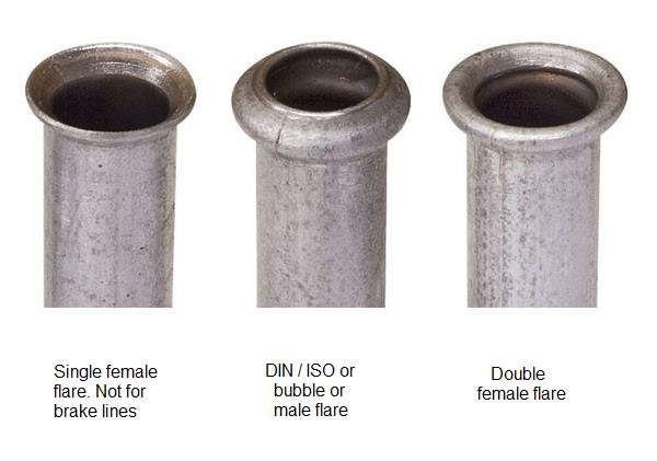

I think we are getting a little lost in terminology. Single and double flares, DIN/ISO bubble flares, male and female flares and fittings. I have always used the terms male and female to describe the flare, male having a convex mating surface and female a concave surface. Male flares are also described as DIN or ISO bubble flares. For female flares, single or double refers to the layers of metal, one or two, in the flares. In my experience female single flares are intended for low pressure lines, not high pressure brake lines which if a female end is needed should be double flares. Examples below.

whilst i am not argueing against using the double female flare. All of the steel brakelines i took of the sierra were single. Is that because they were steel and therefore ok or because it was ok at the time?

ah maybe i didn't look closely enough they were pretty much always covered in oil and crud. will definitely look at the double flare
