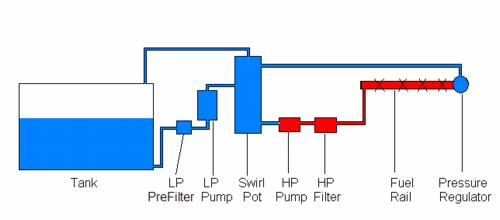

The fact that you can get it to run after a fashion leads me to suspect it's not an ignition problem but more likely to be a fueling problem. It's certainly worth investigating. Firstly what components do you have in your fuel system. What high and low pressure pumps? What filters? What fuel regulator? What fuel injectors and rail? Secondly can you draw a simple diagram to show how they are laid out and their relative positions? Then how are the pumps wired up?

Probably should look something like below pic.

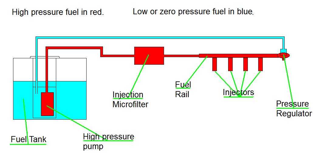

this is a very simple design but should work ............immersible pump in tank (new) two fuel lines to the front of the car one running to a fuel filter and then on to the fuel rail the other coming from the fuel rail to the regulator and back to the tank ,

No you probably don't. The reason I asked you to trace the fuel components, list them precisely and draw a pic of how they are assembled and in what order is so that I and others can see if what you have done has any chance of working.
For instance someone used to running carbs might put the fuel pressure regulator between the pump and the fuel rail as you would do with carbs. In an injection system the fuel regulator comes after the fuel rail.
I would advise doing a pic for your own benefit. Easier to visualise.
I would also suggest a pressure gauge temporarily in line before the fuel rail so you can see pressure (and an idea of flow) under running conditions.
Nigel
Is this what you are running?
