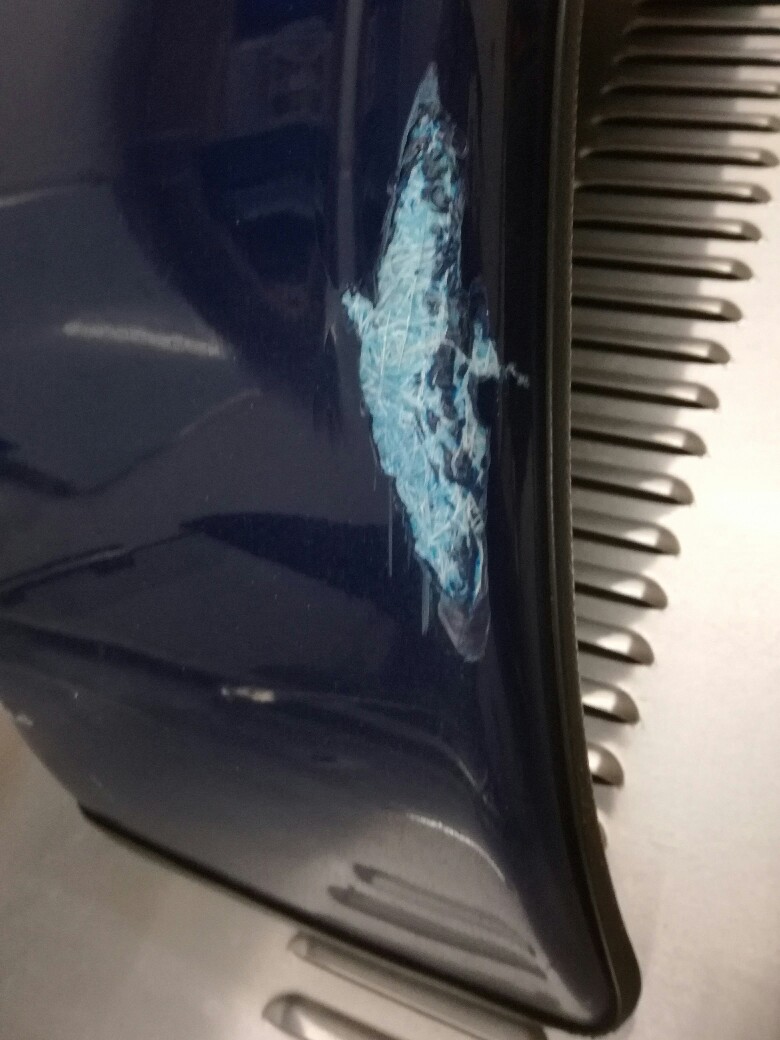

Following on from my wing-ejection event, I need to try and repair some damage, if possible.
I've never done any such repair before so any advice would be helpful. Below is a pic of the damage. It looks like there is a thick layer of plastic over the fibreglass - is that right or is that how fibreglass comes out after buffing up? Is it repairable?
The gloss finish is the coloured gelcoat that's applied first when laying up the guard in its mold. The stranded glass fibre is then put down on top of that. I think I would look for a replacement part as it would be easier than trying to repair it.

Your challenge will be matching the gelcoat colour, to be honest. Assuming there's still some strength in what you have left there, I would just fill it conventionally (either a GRP-based one like P40, or else conventional P38 if there's not that much depth there) and then get the whole arch sprayed. I've never tried mixing gelcoat to match an existing color and I would be worried that the colour you get in the mixing pot prior to applying is a few shades different after the activator has gone off and the stuff has set, and once it's on there'll be no getting it off.

OK, thanks guys - yes, I think a new part would be easier and produce a much better result. Just need to see if GBS will do one arch (they quote them in pairs)....
Follow Dan's advice, it still looks as if the wing has plenty of meat left, so just cosmetic fill & paint --- paint both fronts if there is a slight colour mis-match that shows 'cause there's a chance t'other one will fly if fixed the same.
Yes, I will be re-doing the other wing as well so I could just paint both - good idea. However, if GBS will do me one wing for £40 (£80 for the pair), then that's probably not much more than I'll end up paying for filler, paint etc.

Not a bad plan, but I suspect they won't guarantee colour match between different batches of GRP. Now, to be honest, since it's not butting up against a panel of the same colour, I doubt anyone would casually notice, so I'm not poo-pooing it... but just stating, GRP can suffer from fade over time particularly when left in the sun... some pigments are worse than others though (red traditionally was the worst)...
Unfortunately, GBS want £60 for 1 wing so I'm going to try a fix with P40 first and then a vinyl wrap to avoid having to paint (always wanted to try wrapping anyway ;) ).

Easy repair to do!!! Wouldn't bother using P40 I would go with U-POL SMC Carbon Fibre reinforced filler.
Higher adhesion and easier to work with for a better repair
