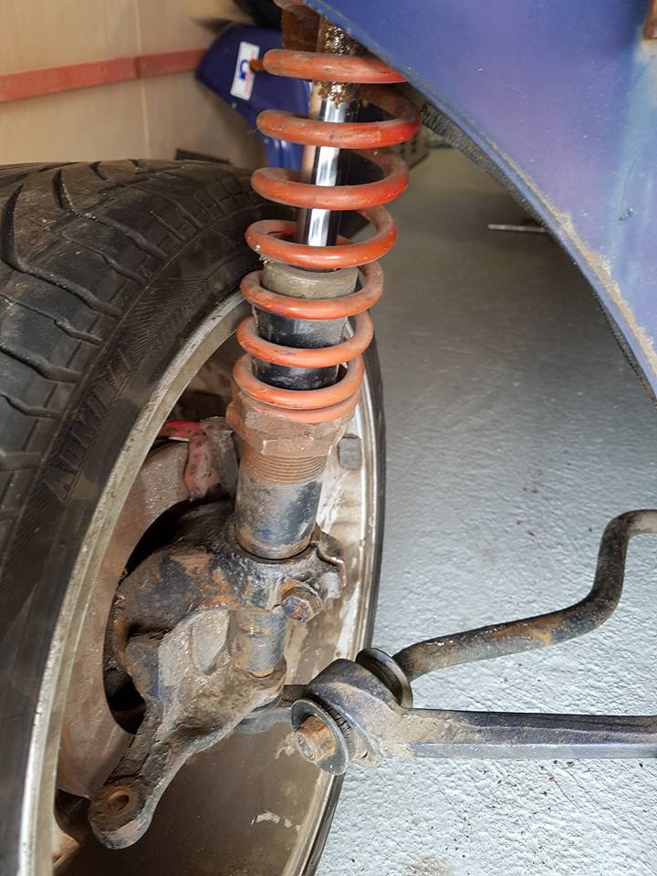

Ive recently bought an exmo kit which has been taken apart. I am trying to piece it back together.
The front struts...i appear to be missing a top mount? The shocker is clamped into the hub and appears to be a coilover type with threaded nut section.
Any idea where i can find replacement shocks and top mounts?

This is what ive got (ignore the wheels, wrong offset but have new ones to go on)

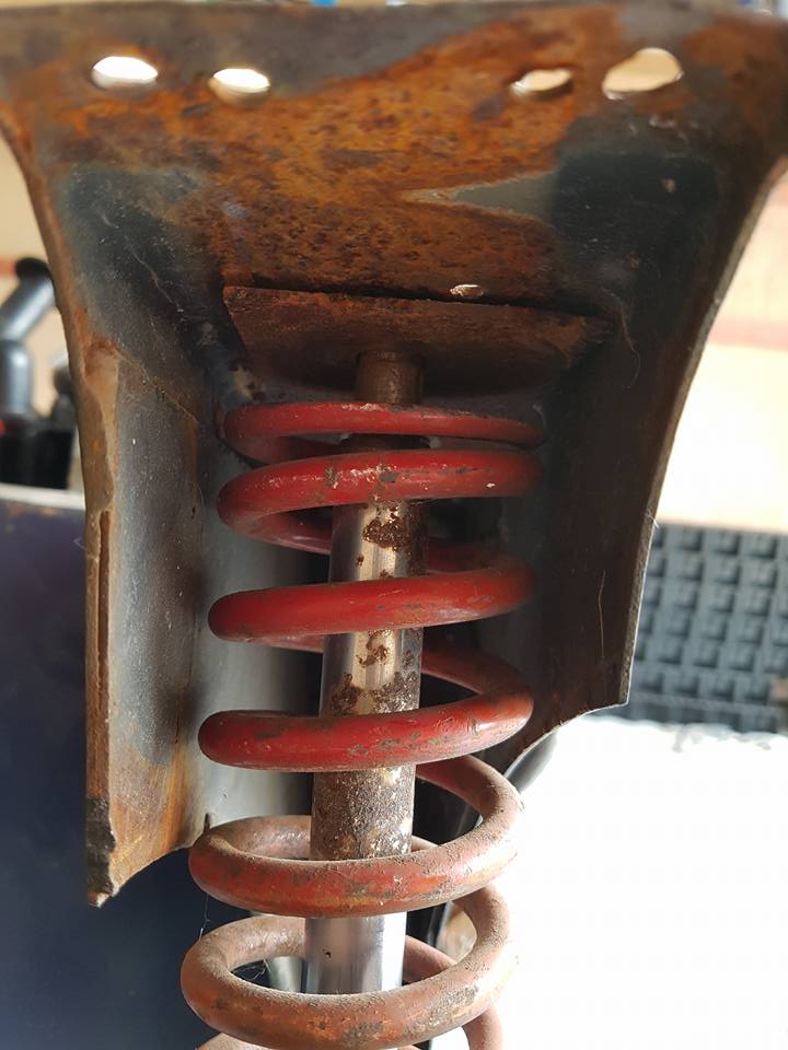

Im currently modifying the front top mount area, to take a ford focus 1998-2004 (Not RS) top strut mount. This will also strengthen the area.
I am fitting ford focus mk1 coilovers, eventually may have to look at changing the spring lb and length, but for now im just wanting to get it all lined up, welded up and the car rolling.
4mm thick steel drilled to suit top strut mount.
