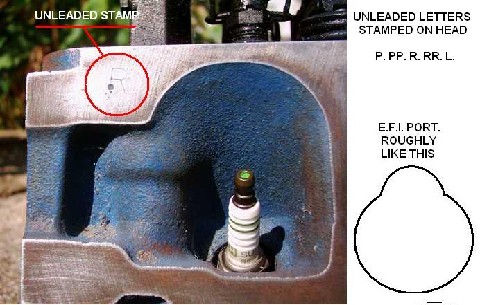

Hi not sure if this is the correct section but here goes anyway,bought a 2b with a 2.0 Efi e reg running gear etc but somethings been on my mind,will I have to modify the head as I dont know if its unleaded or not,any ideas or suggestions would be gratefully appreciated
Ford very helpfully stamped letters on the exhaust manifold face at the back of the engine. 'Made for EFI' heads were all unleaded and had pear shaped inlet ports.
