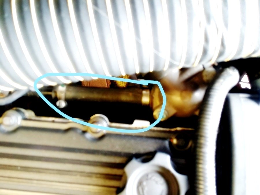

The 1st picture is a small hose that comes from thermostat housing into the expansion bottle.

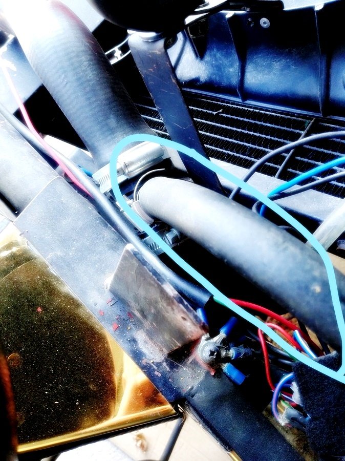

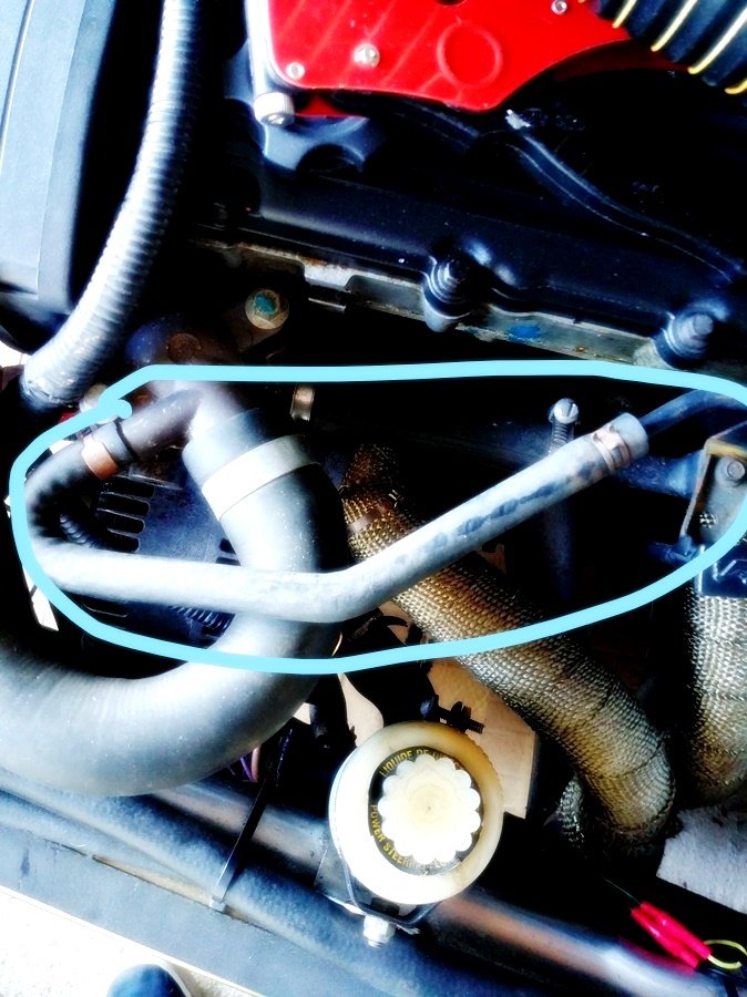

The 2nd and 3rd pics the hose comes from a "T" piece in the bottom rad hose and loops to the thermostat housing.

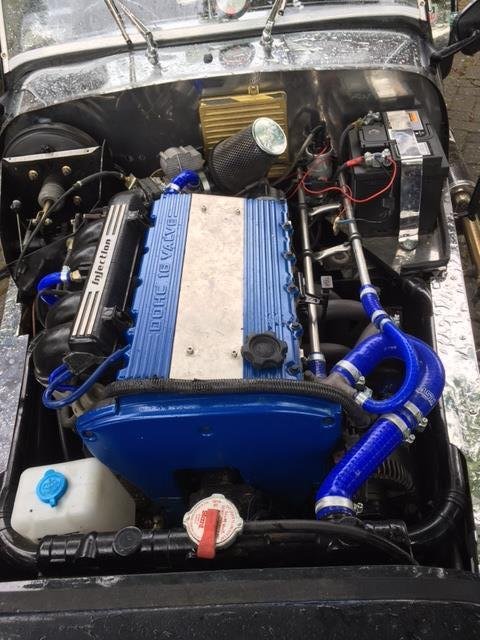

Looking at this image of a super spec that was up for sale a year or so ago they seem to have done away with expansion tank and it looks like they have a heater as both pipes disapear into the car.
Maybe something to experiment with?

You are correct that the 3 pipes off the thermostat housing are for top hose to rad, metal rail over exhaust to feed the heater and expansion bottle (your 3rd photo), and the small hose is for expansion and air bleed back to the expansion bottle (your 1st photo).
In the original plumbing for my Superspec, the heater return pipe was tee'd from the bottom of the expansion bottle, and went back across the top of the engine to the top of the radiator. I did away with this pipe and instead plumbed the return into the bottom hose near the waterpump. This means you are not circulating the whole of the cold radiator during engine warmup. My car now warms up in less than half the time.
You need to have 2 circuits in the cooling system, which are switched by the thermostat:
- main loop, large capacity, large bore hoses, from top of engine and thermostat through the radiator and back into the water pump. This is for main engine cooling.
- secondary loop, small capacity, small bore hoses, also from top of engine and thermostat and returning back into the water pump. This is for quick engine warmup when the thermostat is closed, and also feeds the heater.
If you don't have a heater (I don't) you should connect the heater feed and return hoses to make a small loop back into the bottom hose to bypass the radiator and give you quicker engine warmup.
In the photo of the blue Rover engine it looks like they have changed the radiator and also done away with the expansion bottle. The top tank on the radiator allows for expansion, and the rad cap looks to have an overflow hose either to a catch bottle or venting to the ground. I guess that's another way of doing it, but I'd still prefer to have a proper expansion bottle for the pressurised coolant system.
Also they seem to have plumbed the heater return into the air bleed on top of the thermostat housing. That doesn't look right to me - it should feed back into the waterpump intake.

You need to have a feed from the bottom of the expansion bottle back into the cooling system. That allows the system to refill when it cools. The small diameter pipes off the side of the bottle are really only there to bleed air out the system.
