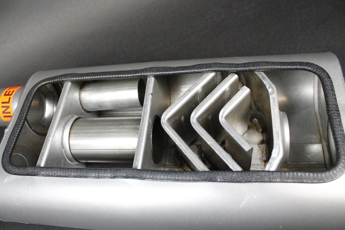

I'm using Power Flow for my exhaust systems they were very reasonably priced and you can find fitters all over. They will design the units to suit you with different noise and sound characteristics plus they are stainless with a guarantee for life.
It's early days for my system as I only had it fitted and IVA tested late last year but it cleared the sound measurement with ease although my power unit is a turbo which cuts down the noise produced considerably and it is pre-cat. I've already had to test guarantee as welding leaked slightly and this was rectified without trouble.
