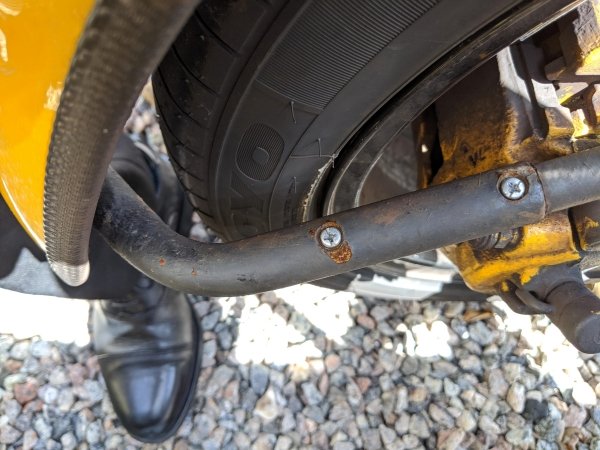

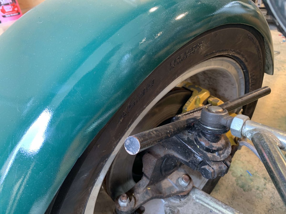

I have so many questions. I was just going through your Blogspot which is extremely informative. I have included a picture showing the front tyre with steel brackets attached to the upper suspension arm but no brackets to attach the fender.

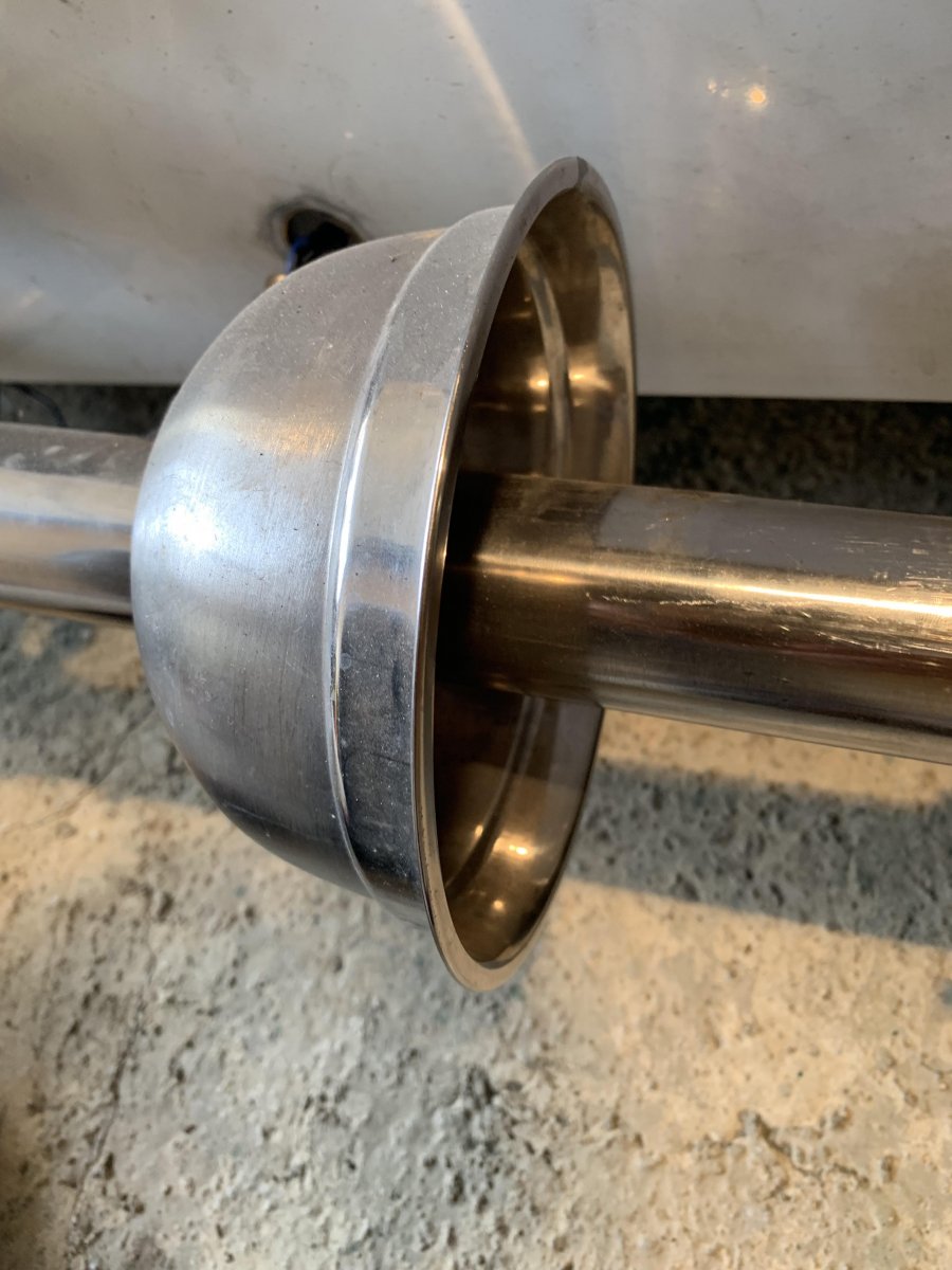

This is the bell end that I need for the other end.

1.  OK, see what you mean.   These are not Superspec-specific, all the cars with Sierra front hubs have the same system.  Not sure if those have an 'official' designation, basically they are just a length of pipe that fits over the bracket, is bent through 90 degs and then the wing is either stuck to them with Sikaflex or bolted on.   Here is a picture of mine.  You will see I have used the 'bolt' method.  Also, it's difficult to see but my original builder drilled holes through the pipe and the mounting brackets to make a good solid fit.

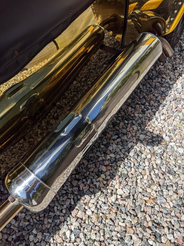

2.  There is no bell end at the other end, it is simply the end of the silencer.  I have replaced my heat shield with a bespoke one, but I am sure there are other owners who still have the standard silencer they can show you.   And I'm afraid I have no idea where Robin Hood sourced the silencer, but to be honest any silencer should do.  Here is mine, and as you may have read in my blog, I have blocked off one of the outlets as I find the engine runs much better with a bit more back pressure.

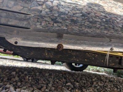

Heres my exhaust and cycle wing stay. The exhaust heat shield is just a piece of stainless steel wrapped around the cat and silencer and bolted together underneath. I think you can get combined stainless exhausts with a built in cat (which is what I may do to mine when it fails).
The cycle wing stays are as Alan said just a piece of metal tube bent at an angle with the wings screwed/bolted/glued to them.

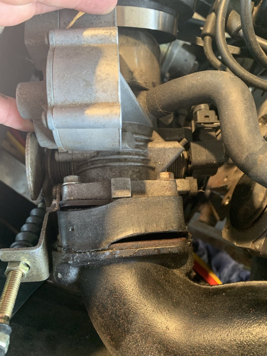

Ok so my next issue is on the throttle body rubber mount which is broken and stalls the car. eBay is not coming up with the item, maybe it’s called another name. Any ideas or 2nd hand ones around?
Rimmer Bros should always be your first call for all things Rover.   They are showing a 'throttle body to intake seal' at https://rimmerbros.com/Item--i-LR024989.   There isn't a picture so you need to call them to confirm it's the right bit.

I'm not sure the part that Al has quoted is correct for the T-series engine, as that link is for the RR Evoque.
I think it should be this one on the Rimmer page for the Rover 800 https://rimmerbros.com/Item--i-GRID004682
Item no 4 on the diagram and in the list, p/n JZV1085 - Mounting-multi point injection throttle body flexible.  But it's not a cheap bit of rubber!!
Throttle body rubber mount.  Mine came unstuck too - just stickaflexed it back together.
The front fender brackets originally came as one single piece of tubing all bent with many angles.  The builder had to cut it up into four pieces (two forward supports, two rear supports).

Rimmerbros sorted me out for my throttle body mount.
found a silencer from local spares supplier.
got my cycle wings on.
