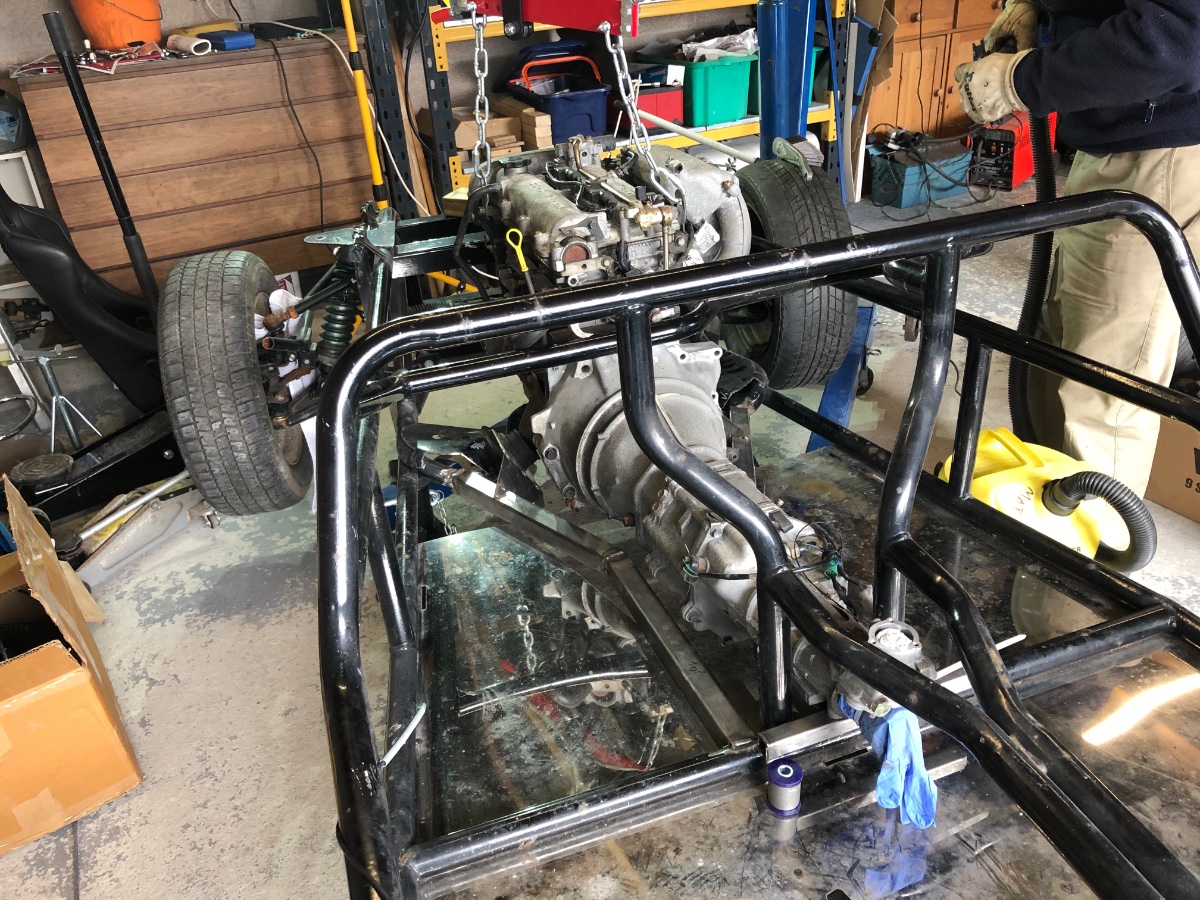

I am currently fitting a 1.8 MX5 engine and gearbox into a 2B. You will need to fabricate engine and gearbox mounts but no chassis modifications are needed to get the MX5 unit into the 2B.
I bought a 2004 MX5 with MOT failure due to corrosion and stripped everything including ECU and entire wiring loom.
So far I am in profit in that the proceeds from selling old pinto engine and gearbox plus unwanted parts from the MX5 (roof, doors, seats , bonnet etc) has more than covered what I have spent.
The MX5 sump needs to be shortened. You will need not get a prop shaft made/customised. I have made my own floor mounted pedal box. I have also used/customised the MX5 exhaust manifold.
At the moment I am trying to sort out the wiring loom. Stripping out everything that is not needed etc.

We are also in the early days of fitting an MX5 1.8vvt to a previously part build 2B. Engine and box fits nicely and now we are onto working out the pedals and steering column type and position.
Chris
