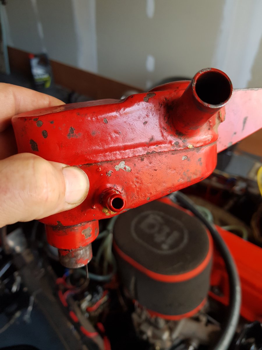

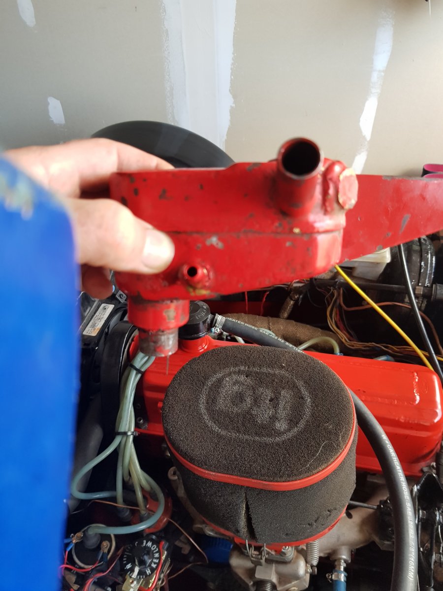

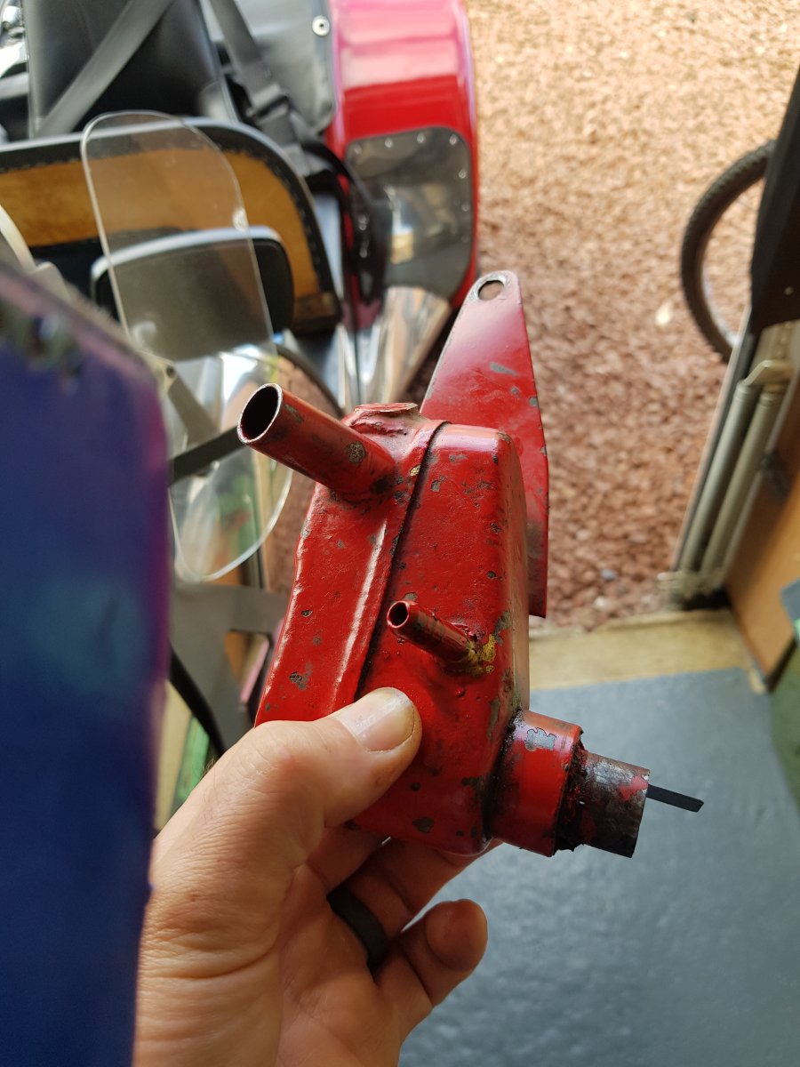

Re your red bit, looks like it’s been modified, I suggest the upper hose goes to a catch can, possibly the lower was supposed to be a return from the can but as it will be slightly pressurised when running it wouldn’t work. Try blocking off the lower connection. Make sure your catch can has a decent breather on it.
This hopefully is a link to Dave Andrews site it has loads of useful info and this may be the oil breathing bit! http://www.s262612653.websitehome.co.uk/DVAndrews/wateroil.htm
You need to take the PCV off as it only works with manifold vacuum.
the catch tank should be baffled with wire wool in and have a separate filter outlet or vented cap.
you run a pipe from the crank case to the tank and another from rocket cover vented cap to second catch tank inlet or out of the rocker cover itself.
i run 16mm outlets and pipes.
another system is to run the crankcase breather to the rocker cover and run a second outlet from the rocker cover to the catch tank to reduces oil loss.
on later blocks there is a plug into the crank case on the right hand side that can be used as an oil return or a second crank case breather
I have learned this by painful experience and a lot of trial and error
