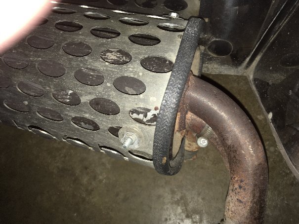

I am panicking now, thinking that I may have missed something.  I have fitted a heat shield to the silencer, because it had sharp edges that I could not get round.  However, the edges of the heat shiel, although they have rounded edges, still seem more dangerous than the origional sharp edges I was trying to avoid.  I have enclose three picture of said shiel .  What are your thoughts rearding the IVA test?
Just put normal edging strip along the edges.   I did mine a year ago and although the shield gets hot the strip can take it.
Do you not need a rolled edge outlet bend on your tailpipe?
To direct the fumes away from the side of the body.

the silencer is off a Honda Blackburd 1400cc. itis angled down but it only protrudes 1".
23 hours ago, brumster said:
Radiused to 2.5mm? I can see the edges, they look radiused to me?
