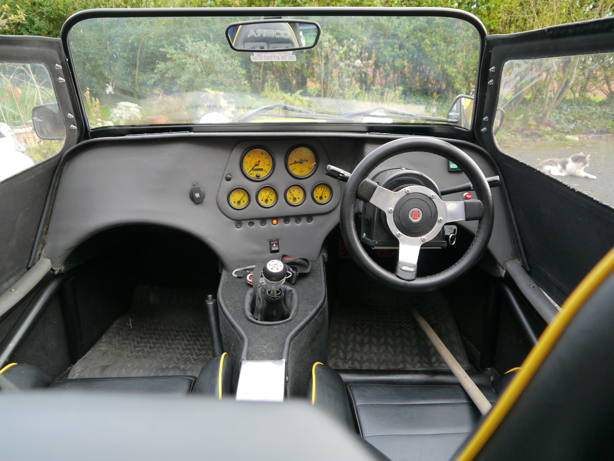

Hi my car was built by GBS and is a 2b Superspec my dials are like this  ! Hope it helps and they are all visible when you are driving there are two screws that hold the dials panel in place.
