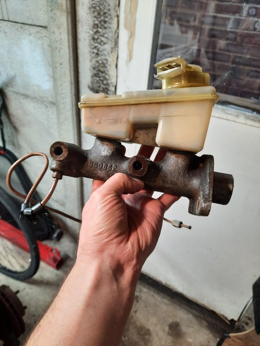

I have just removed mine, see pic below. Is this what you need? I also have the diaphragm if you need one. The brake pipe that is still attached has a rusty union and ground off, but won't take much work to get that out.

Sorry for the slow reply. My cylinder is different with the res holes right next to each other. Thanks for the photo. I may go get a Ka cylinder as suggested.
           Thanks for your help.
                                              Graham.
