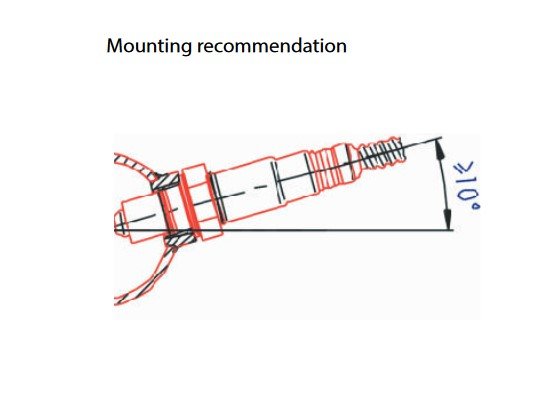

Other thought is that bosch state that sensor must be mounted at an angle but not vertically down so that condensation cannot form on the tip but drips off to the side of the tip. Recommended angle is 10 degree wire up from horizontal.
Yeah, I know but unfortunately, the exhaust system from GBS I used only has the hole at the top, only allowing a vertical setup. But there are lots of others using it like that (in fact, I've never seen a sensor at anything other than vertical 😏).

Do not power the sensor heater until the engine is running as any condensation ( from a cold engine/ inlet mainfold etc. ) hitting a hot sensor can damage the sensor by thermal shock. Once the engine is running the condensation will be blown out and the header will quickly warm past condensation temp.
If that was the problem, wouldn't the damage have been done now? Which could exactly be the reason why it is now knackered... 😕

Unfortunatly forensic examination of the sensor is expensive and from reading Bosch data sheet they have already done this and warned about this failure mode.
Keeping in a dry garage is probably best protection.
