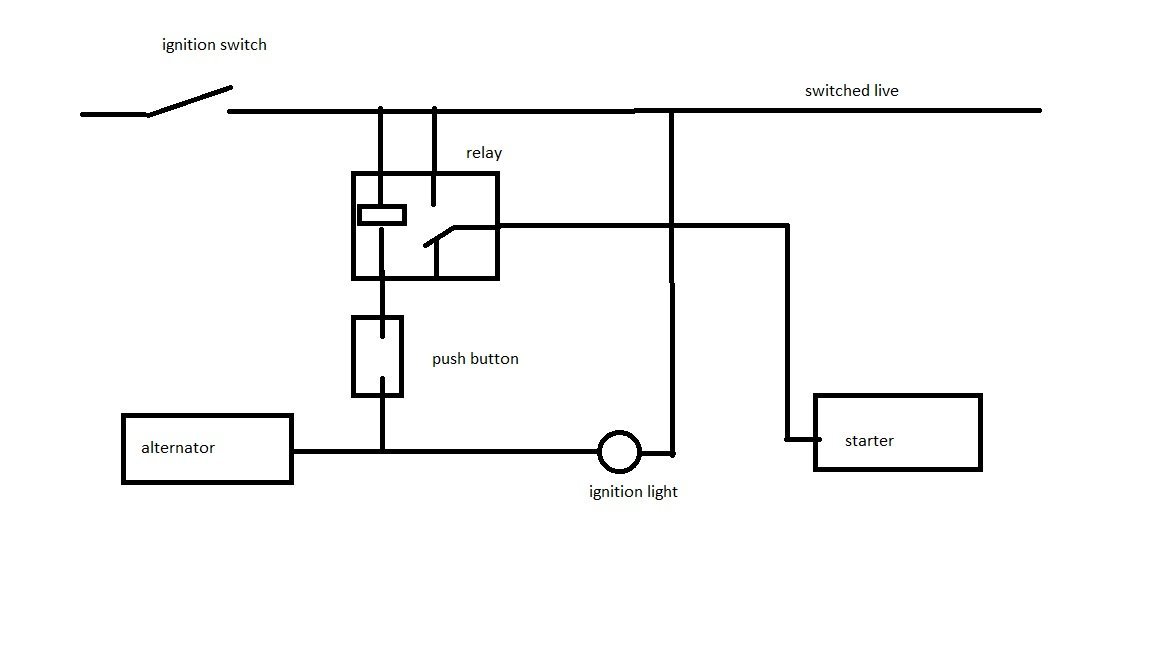

So you probably will need a relay to do this.
I would connect one end of the relay coil to a switched live and the other end to a normally open push button.
I would connect the other end of the push button to the alternator end of the ignition light. With the engine stopped this will be near 0 volts and current will flow through the relay coil. With the engine running this will be 12+ volts and no current wil flow through the coil.
The normally open relay contacts can then be connected to a switched live and the starter.
I hope that this helps
Quick look at IanS diagram, can't think of another way off hand,

I should add this is not tested but I think the worse that can happen is that fuse 1 blows

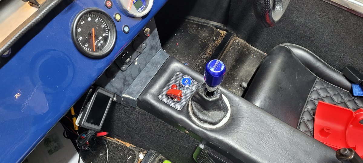

Having said that, I have since seen a nice carbon fibre starter panel, with a switch under one of those fighter plane-style protectors which enables the starter button. A faff to start the engine but will look cool... I'll have a think.

Very proud of the final result - the panel I bought included an on/off switch for the starter button, so i could use a much simpler circuit than suggested here (details in my blog) . Looks great and works a treat:
