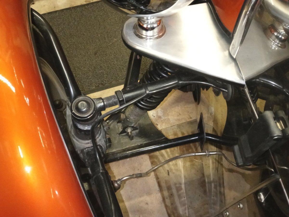

Hi Guys,
Has any one fitted this modification to their 2B and can provide me with a photo as I want to check I have everything correct .
Steve D
Yes this is the kit I have to fit, I just wanted a photo of a front corner to check I have everything fitted okay if thats possible do you also have GAZ shocks and did you position the shock mounting U bracket to the lower wishbone in a different place to the standard hole provided.
Many Thanks
I have Gaz dampers fitted before the handling pack and I didn't need to move the lower fixing on the wishbone.
Edited by richyb66

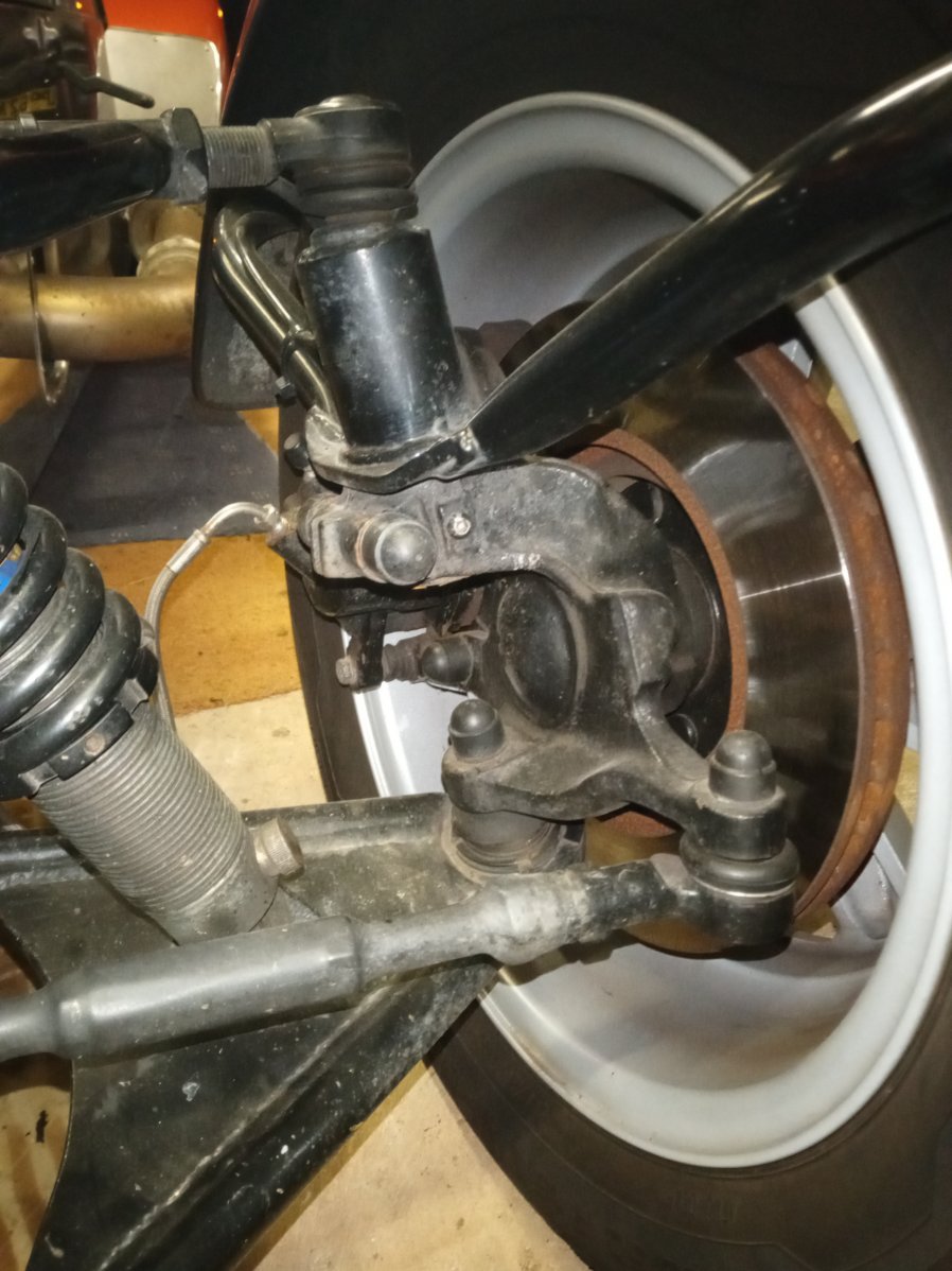

A degree or so of negative camber (in at the top) won't hurt.
The limiting factor is you can only rotate the top ball joint in the wishbone by whole turns and still have the taper pointing down to fit in the hub upright. This can make it impossible to get the same camber on both sides.
A friend with a sliding pillar 2b bought the double wishbone kit and fitted it, I have photos of what needs to be cut and where the brackets go somewhere, send me your email and I’ll look them out for you.
